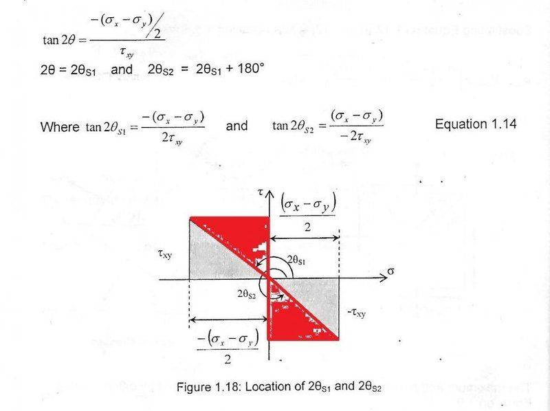

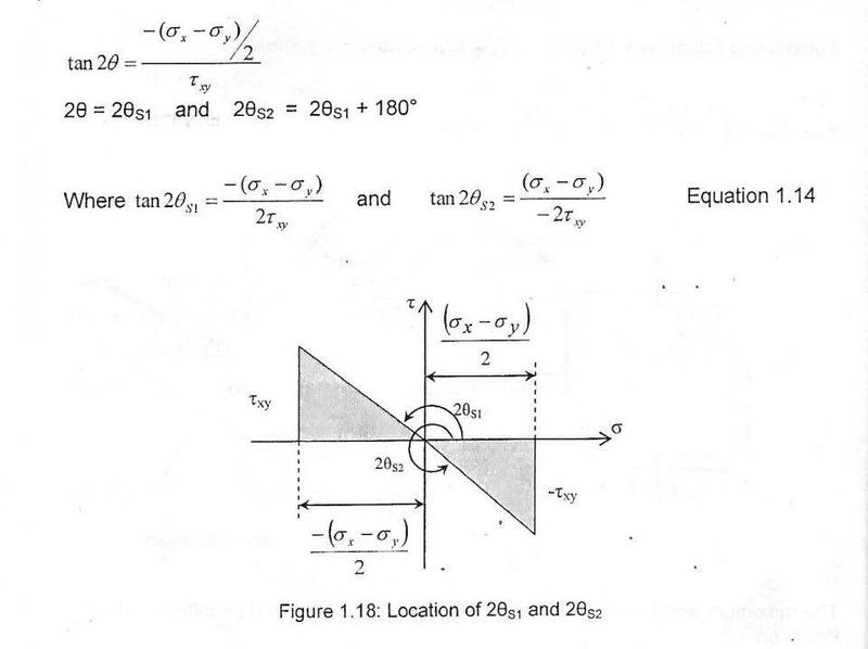

this is actually mohr's circle formula, forget about the theory,let's focus on the mathematics part. I couldn't understand why the tan( 2 θs1) = -(σx -σy) / 2τxy ?
2θs1 is outside the triangle
theorically, tan(180-α )= -tan( α ) , so tan( 2 θs1) = -(σx -σy) / 2τxy , the vertical staright line of triangle should represent -(σx -σy) , whereas horizontal axis represent 2τxy , am i right?

Lessee ... looking at the triangle on the right, basic trig says that ##\tan(180-2\theta_{S1}) = O/A## where ##O=\tau_{xy}## and ##A=\frac{1}{2}(\sigma_x-\sigma_y)## ...
which triangle do you mean? , where is it?
tan [ theta(S1) ] is (σx- σy) / 2 τxy , where ##A=\tau_{xy}## and ##O=\frac{1}{2}(\sigma_x-\sigma_y)##
Simon means the grey triangle on the right, and I agree with his equation.
The tangent will be negative, and it will be vertical displacement divided by horizontal displacement, so ##\frac{2\tau}{\Delta \sigma}##.
You can check this by thinking about the coordinates of the top corner of the left-hand grey triangle in polar: ##y=r\sin(\theta)##, ##x=r\cos(\theta)##.

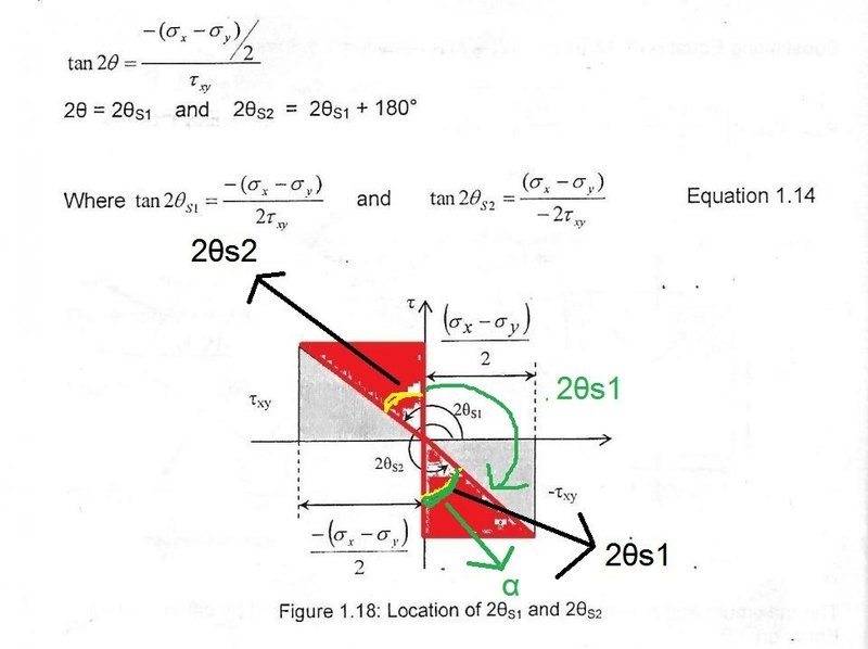

well , refer to the green colour , igonre the black colour label , so 2θs1 is measured in this way ? so , tan2θs1 = - tan(α) = - (-(σx - σy)) / 2τxy = (σx - σy)) / 2τxy
P/s : I let 180 - α = 2θs1 , so tan (180 - α ) = -tan( α )
Am i right ?
why we need to switch theta to be measured from the positive vertical axis ? why we can't measure it directly from negative vertical axis ?

Green? Where? Did you mean to attach an image in post #13?
chetzread said:
180 - α = 2θs1
Ok, if you switch to measuring clockwise that will switch the sign.
Doesn't help. tan(θ+π)=tan(θ).

here it is . sorry

well ,
Is my idea correct ?
chetzread said:
well ,
If you measure the angles clockwise from the vertical axis, as you have with your green arrows, you will get the tan to come out the way you want.
