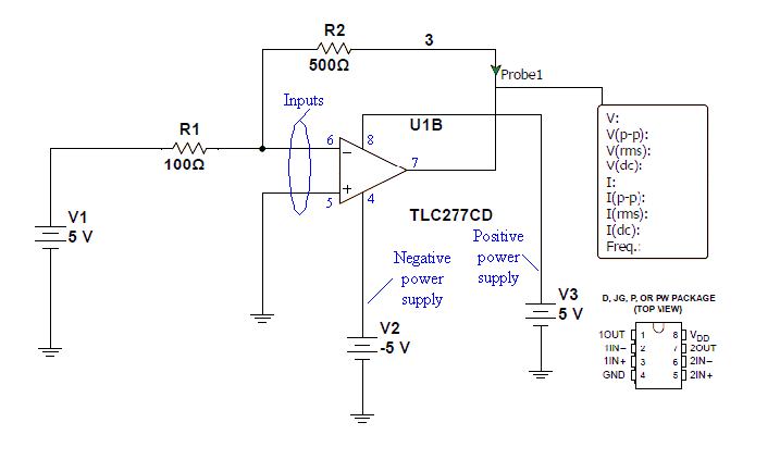

Here is my inverting amplifier, it won't actually run at the moment, something is messed up with this circuit.
Check your power connection pins. You seem to have their polarity reversed (note the negative sign on the V2 magnitude. That makes V2 negative with respect to V3). Here's your circuit diagram with the pin labeling fixed.
You'll probably want to reduce the V1 supply value. The output of the amplifier can only swing between the power supply values, so +/- 5V in this case, and you're hitting the input of the amplifier with +5 volts; there's no way the amplifier can produce an output of Gain multiplied by 5V when Gain is greater than 1.

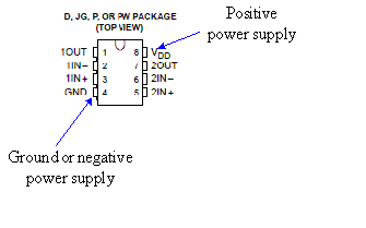

How is the positive power supply pin 8? There is a negative right there at the top of the op-amp. Is the positive power supply label Vdd (pin 8) and GND (pin 4) the negative supply label?
Yup. Vdd and GND are as specified on the pinout diagram. The "+" and "-" on the op-amp symbol are to distinguish the inverting and non-inverting signal inputs.
Okay, now I switched the polarity. It is weird to me that the positive power supply has a negative voltage and the negative power supply a positive voltage.
Also, it looks like my simulation is not producing an output voltage that is -5Vin, it is -4.88Vin. Why would the resistances matter, as long as they are in a ratio of 5/1? The question implies to me that there are specific resistances.

Huh? You have +5V on pin 8 and -5V on pin 4. That's correct, and not reversed :confused:
It could be that the op-amp is not capable of driving all the way to the supply rails. This is often true of real op-amps. You might want to look through the spec sheet to see how closely it can drive its output to the rails. Also, check the amplifier response to smaller inputs to see if it is linear if you avoid driving the output close to the rails.
Yes, it's the resistor ratio that matters and you can choose any sizes within reason. If they are too small your amplifier may load down the signal source by trying to draw too much current (that is, your amplifier's input impedance will be too low), or if they are too high then the amplifier may be affected by thermal (shot) noise in the resistors producing enough current to generate voltages across the resistors that will be amplified and seen at the output.

Check your power supplies. Pin 8 should be connected to the positive supply and pin 4 to the negative supply. Always refer to the pinout diagram on the spec sheet.

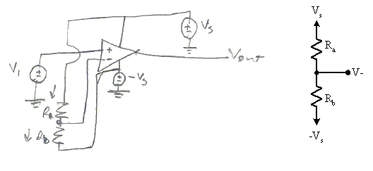

Also, I'm doing page 6 of the lab and I have no idea what the circuit is supposed to look like for the comparator. They don't say where the resistors should be placed, and the image up top doesn't give any indication either. Then they want a relationship between Ra, Rb, and alpha.
Here is at least what I drew as a circuit
Your circuit looks fine. I've reproduced it here and extracted the portion of interest:
Now, you are aware that the potential at the V- pin of the op-amp will define the threshold voltage where the comparator output will make the flip between rails. So emply superposition to determine V- from the isolated circuit. You should end up with something of the form
##V- = (something)\cdot V_s##
