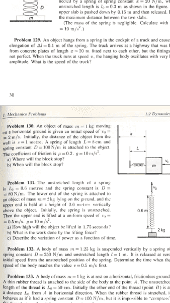

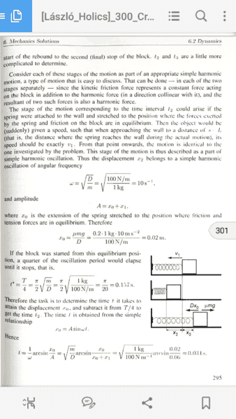

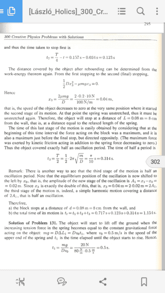

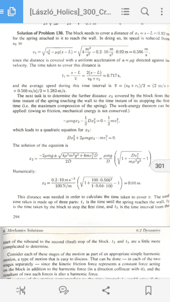

So In the following picture is the problem and its solution (Problem 130)
KE =1/2 m v2 x:=w^2x
I am confused of the fact that the time from the spring touching t2 is T/4-t where T is the period oscillations while t is the time to reach equillibrium position.Is it not supposed to be the sum ? Another one is the final work energy statement , why would there be x32 is it not supposed to be x2 ?
