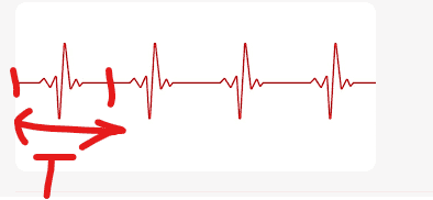

I concur with @jbriggs444. Can you come up with a sharper definition? How do you define "the same"? What if the motion is complicated? For example, the picture shows the readings of an electrocardiogram (EKG). Is the heartbeat as evidenced by the EKG periodic? What makes, or doesn't make, it so?
A motion is periodic when the period of each cycle is the equal. A cycle of the motion starts and ends at the same point which can be arbitrarily chosen.
I think the EKG is periodic because it starts and ends at the same point and the period is the same for each cycle.
Is that better?
Many thanks!
I agree that the EKG is periodic, but you're not there yet.
What starts and ends? What same point? Time increases to the right on the horizontal axis and no point on it is the "same" as some other point on it. The vertical axis is voltage.

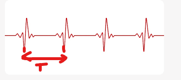

I tried to draw what I think is the period of the EKG,
The period will be the same as long as you find the same points each cycle, for example,
So when I mean by the 'same' points (coordinates on the EKG graph) in that they have the same voltage values, but different time values. The difference between the finial and initial time values for the same voltage is the definition of the period, correct?
You are definitely on the right track, but there is one final step that we all want you to take to use the standard test for a periodic waveform, as hinted about by this reply:

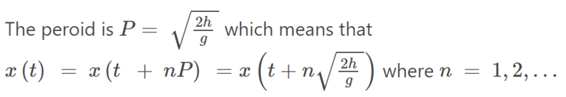

Thanks for your reply @berkeman! I found after some research, that a period function must have the following property:
Where P = the period of the function and n = non-zero integers.
To me all that equation is really saying at that for a function to be periodic, there must be at least two x-values that have the same y-value. But then that would include parabolas?
I don't think parabolas are considered periodic functions, so I think the correct interpretation is that there must be a domain of x-values which have the same y-value.

That equation says that for every x, there are infinitely many other x-values that have the same y-value. Those x values are x+p, x+2p, x+3p, ... along with x-p, x-2p, x-3p, ...
So you can take a snapshot of one period of the graph, slide it over by one period and have something identical to the snapshot of the next period.
Now then, you quote an equation which says that the period is:$$P=\sqrt{\frac{2h}g}$$But that period is the time to fall from rest to ground. If you take a snapshot of that much of the graph and slide it over by one period, does it match the next piece of the graph?
I believe the period should be ##P=2\sqrt{\frac{2h}{g}}##, i.e. twice the time it takes to reach the ground from height ##h##. To complete the cycle, it has to go back to the release height.
I would just say that if t=0 is the time the ball was dropped at rest from the height h, the ball will get back at the height h and have speed 0 at t = P.
Periodic motion is same position and same velocity when the time P has elapsed.
