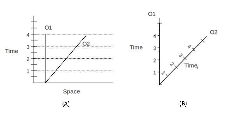

I really find difficult understanding what spacetime diagram does relativity use while defining its notion of space and time and moving observers.

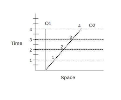

Can we place both a still and moving observer in the same space time diagram as in the figure (A), then the moving observer measures time going slow. Or does the moving observer also measure time with the same speed as in figure (B). In that case how does one see the other's time slowed down?
You can put them both in the same diagram, but you have to draw different x and t axes for the two observers. Any single event is represented by a single point in the diagram, but it will have different x and t coordinates according to which pair of axes you use.
And what about the figure (B), is it valid?
No, it is not valid. You are showing the passage of time for O2 contracted instead of dilated. If you want to see a lot of spacetime diagrams, including some that illustrate how one observer can determine the Time Dilation of a moving clock, do a search on my name for the word "diagram".

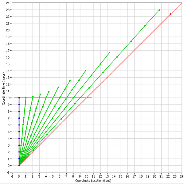

Taking one of your above spacetime diagrams, why should the green lines (moving observers) have longer distance between two time coordinates? can't they be the same as the blue line (still observer) or if they had to be longer then why not as shown in this below figure
(and also tell me how do you post such an enlarged picture within the post, but mine appears small)
Although in your diagram, the distance on paper shows the spacing between times as longer, that's strictly because of the motion. They need to have their time coordinates stretched out. Here's how to do it correctly. Start with a diagram showing a stationary observer like you already did. Then use the Lorentz Transformation process for both x and t to see what the coordinates are in a new frame moving with respect to the original one. Hint: use units where c=1. Draw a new diagram. Once you see how time is dilated for moving objects, you can just bypass this step and draw them in correctly based on the value of gamma.

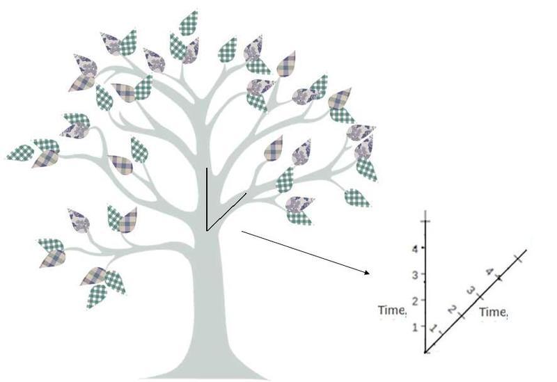

Ok, now let me put it different way. Let's forget about the space time diagrams and the coordinate system. Simply view time as a four dimensional space. Here it is a pure space and one dimension cannot have any distinctness with respect two any other dimension, just as in our three dimensional space, all three dimensions are not distinct from each other in any way.
Now we can consider various moving observers as going at different angles like the branches of a tree as shown below. (more angle means more relative speed) But two observers moving relative to each other will measure their time going at an equal speed i.e. the length/distance between their two points in time is equal for both observers as shown here (since we have accepted that their direction in a 4d space do not actually matter)
So considering this, my question is how do the two observers see each other's time as dilated? Can we explain it without using the general sp-time diag.

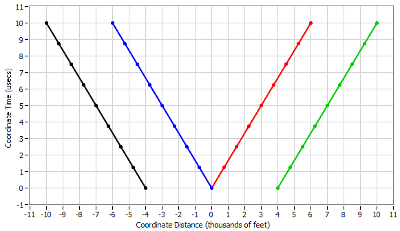

Here is a spacetime diagram showing two spacecraft departing from each other at the same opposite speed of 0.6c in this Inertial Reference Frame (IRF). I'm defining the speed of light to be 1 foot per nanosecond. The dots represent 1 microsecond intervals of Proper Time along each worldline:
Note that the spaceships are both 4000 feet long in this IRF.
However, if we look at the IRF corresponding to the rest frame of the Black&Blue spaceship, we see that its Proper Length is 5000 feet:
We can also easily see the Time Dilation of the Red&Green spaceship by dividing the Coordinate Time of 17 usec by the Proper Time of 8 usec for the top red dot yielding a Time Dilation factor of 2.125 which also the value of gamma for a speed of 0.882353 (the relativistic sum of 0.6c and 0.6c).
We can take the inverse of gamma, 1/2.125 = 0.471 to confirm that the Length Contraction of the Red&Green spaceship is 5000 times 0.471 or 2353 feet. At the Coordinate Time of 17 usecs, we can see that the green line is 2353 feet further to the right than the top red dot.
Here is the IRF in which the Red&Green spaceship is at rest:
And we can confirm that the Time Dilation and Length Contraction factors are reciprocal, that is, in the rest frame of each spaceship, the other spaceship is Time Dilated and Length Contracted to the same degree.
Can you please show us how the first diagram shows these effects any easier than the other two diagrams?
