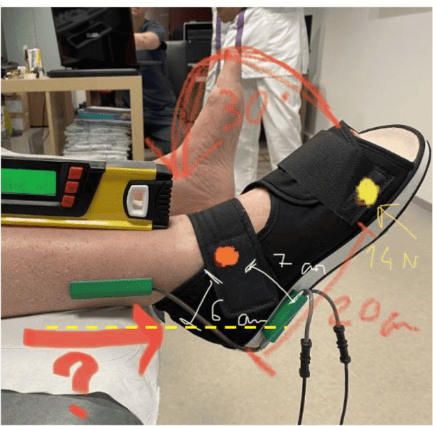

Good morning,
I’m new to the forum, thank you in advance. I’m an Italian med student based in France.
I’m struggling to find an equation for a project that I am following.
I should measure the reactive force at the level of the gastrocnemius (shown in the figure, red arrow). I know the force applied on the plantar side of the foot in the direction of the knee (14 N), the angle of ankle dorsiflexion (30 degrees), the position of the center of rotation in cm (the medial malleolus at the red spot) and the height of the force applied on the foot (20 cm at the level of the yellow spot).
Anybody knows if with these values is it possible to measure the reactive force (red arrow) that is opposed to the plantar force?
Best Regards,
Riccardo.

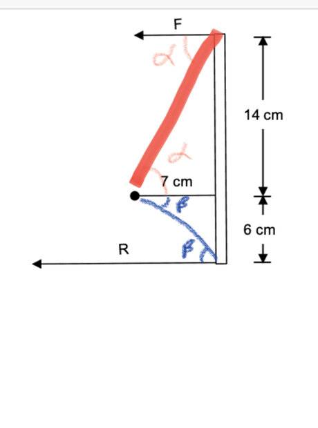

Hi @Richard90 and welcome to PF. I have two questions for you.
1. Is the 30° angle really measured from the vertical as shown in the photo? It looks like 60° to me.
2. Where is line of action of the unknown force? Is it (more or less) along the yellow dotted line shown below?

Good afternoon Kuruman,
Thank you very much for your answer,
Yes, exactly on that line and should counteract the force applied and on the plantar side of the foot.
The image is not exact, the foot should be at 90 normally. The starting point is at 90 degrees of flexion (foot perpendicular to the leg). The angle is measured from a flexion more than 90.
Do you think there is a equation to approximate the moment of force on the yellow line you have drawn?

Richard90 said:
with the ankle at 90 degrees, 20 - 8 cm = 12 cm from the center of rotation, the resulting force should be 9.3 N? (14:12 / x:8) 14x8 / 12= 9.3 N
I don't understand these numbers. The measurement in the photo says 7 cm not 8 cm but that's a minor problem. The major problem is that the reaction force is less than the applied force. That can't be correct because the lever arm of the reaction force is shorter than the lever arm of the applied force. I think you tried to do it in your head instead of drawing a good diagram. The diagram below is drawn to scale for the 90° ankle angle using the numbers from the photo. Can you calculate R now?
We will worry about the 30° angle later. In fact I think finding the reaction force for an arbitrary angle θ would be better.

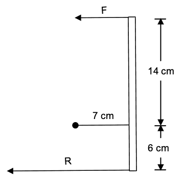

Thank you for the diagram,
It should be F * 0.14 * sen alfa = R * 0.06 * sen beta ,
R = F 0.06 sen beta / 0.14 sen alfa, but I don’t know how to mesure the angles. Is it right the equation? I did the scientific high school but I forgot almost everything. And then how to apply the 30 degrees of flexion?
I think I don’t have the capability to find and solve the equation..
You don't need the angles. The lever arm is defined as the perpendicular distance from the axis of rotation to the line of action of the force. The torque is the force times the lever arm. The lines of action of both forces are horizontal. What are the perpendicular distances from the axis of rotation to those lines of action? Read the plot.
To have the system in balance the force R should be 32.6N? And then the ankle flex just 30 degrees because is limited from gastroc contracture, how is possible to solve it?
That is correct.

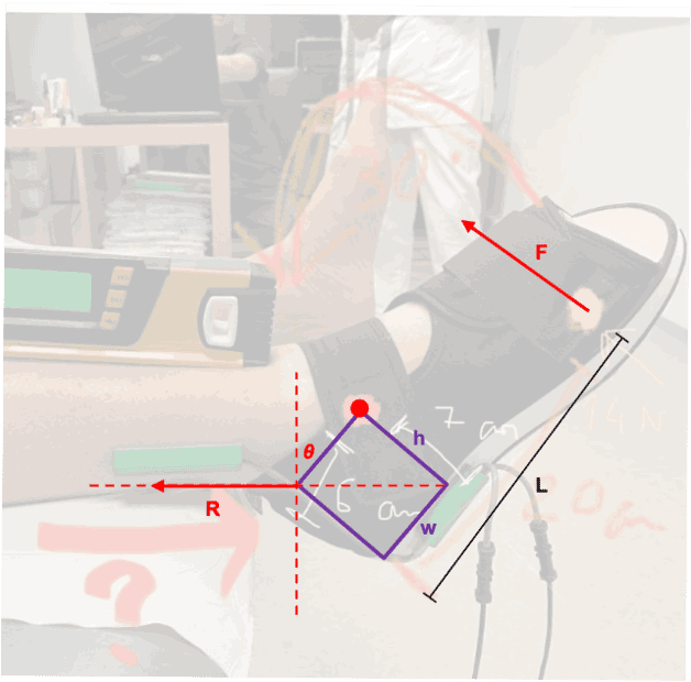

What you use depends on where the action line of reactive force is. Shown below is the way one could approach the problem. In the picture h = 7 cm, w = 6 cm, L = 20 cm and θ is some arbitrary angle. I have assumed that, as the ankle flexes from θ = 0 to some other value, the distance w from the center of rotation (red dot) to the point of application of R remains the same. Is that correct? If it is correct, then the lever arm of the torque generated by R is ##w~\cos\!\theta## and changes as the angle changes.
I have a question for you to satisfy my own curiosity. Is it necessary to measure the reactive force when the foot is at some angle? As you say, there is the problem of intrinsic elasticity that varies from subject to subject. Why not measure it when when the foot is vertical?
