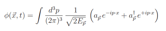

We first expand out ##\phi \sim a + a^{\dagger}## using the following formula
Doing so we get
$$<f|S|i>=-ig<f| \int d^4 x \psi^{\dagger} (x) \psi (x) \int \frac{d^3 k \sqrt{2E_{\vec p}}}{(2 \pi)^3 \sqrt{2E_{\vec k}}} a_{\vec k} a_{\vec p}^{\dagger} e^{-ikx} |0> = -ig<f|\int d^4 x \psi^{\dagger} (x) \psi (x) e^{-ipx} |0>$$

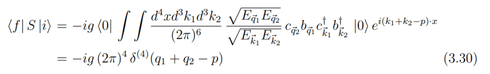

He uses the same argument to justify the final solution:
With this thread I am aimed at understanding and getting the provided solution.

Please let me show all my work and then add some comments.
So we were dealing with the leading order in g
$$\langle f|S|i\rangle=-ig \langle f| \int d^4 x \psi^{\dagger} (x) \psi (x) \phi (x) |i \rangle \ \ \ \ (1)$$
I'll go step by step
1) We plug the mode expansion for ##\phi## and the given definition for ##|i\rangle## into (1) to get
##\langle f|S|i \rangle =-ig \langle f| \int d^4 x \psi^{\dagger} (x) \psi (x) \int \frac{d^3 k \sqrt{2E_{\vec p}}}{(2 \pi)^3 \sqrt{2E_{\vec k}}} \Big(a_{\vec k}a_{\vec p}^{\dagger}e^{-ikx}|0 \rangle +a_{\vec k}^{\dagger}a_{\vec p}^{\dagger}e^{ikx}|0 \rangle \Big)##
Thanks to your explanation at #9 I see that we have ##\langle 0 |a_{\vec k}^{\dagger}a_{\vec p}^{\dagger}| 0 \rangle=0##. So we end up with
$$\langle f|S|i\rangle=-ig \langle f| \int d^4 x \psi^{\dagger} (x) \psi (x) \int \frac{d^3 k \sqrt{2E_{\vec p}}}{(2 \pi)^3 \sqrt{2E_{\vec k}}} a_{\vec k}a_{\vec p}^{\dagger}e^{-ikx}|0\rangle \ \ \ \ (2)$$
2) Use the commutation relation ##[a_{\vec k}, a_{\vec p}^{\dagger}] = \delta^3 (\vec p - \vec k)##
Based on the commutation relation we know that ##a_{\vec k}a_{\vec p}^{\dagger}=\delta^3 (\vec p - \vec k)+a_{\vec p}^{\dagger}a_{\vec k}##. Plugging it into (2) we get
$$\langle f|S|i\rangle=-ig \langle f| \int d^4 x \psi^{\dagger} (x) \psi (x) \int \frac{d^3 k \sqrt{2E_{\vec p}}}{(2 \pi)^3 \sqrt{2E_{\vec k}}} \Big( \delta^3 (\vec p - \vec k)+a_{\vec p}^{\dagger}a_{\vec k} \Big)e^{-ikx}|0\rangle $$
We know that, by definition, we have ##a_{\vec k}|0\rangle = 0##. Thus (2) of course becomes
$$\langle f|S|i\rangle=-ig \langle f| \int d^4 x \psi^{\dagger} (x) \psi (x) \int \frac{d^3 k \sqrt{2E_{\vec p}}}{(2 \pi)^3 \sqrt{2E_{\vec k}}} \delta^3 (\vec p - \vec k) e^{-ikx}|0\rangle$$
Based on the famous sifting property of the Dirac delta function (i.e. ##\int f(t) \delta (t-T) dt = f(T)##), we compute the following integral
$$\int \frac{d^3 k}{\sqrt{2E_{\vec k}}} \delta^3 (\vec p - \vec k) e^{-ikx} = \frac{(2\pi)^3}{\sqrt{2E_{\vec p}}} e^{-ipx}$$
Thus we end up with
$$\langle f|S|i\rangle=-ig \langle f| \int d^4 x \psi^{\dagger} (x) \psi (x) e^{-ipx}|0\rangle \ \ \ \ (3)$$
3) Recall the mode expansion of the complex field
$$\psi = \int \frac{d^3 k_1}{(2 \pi)^3} \frac{1}{\sqrt{2E_{\vec k_1}}}\Big( b_{\vec k_1}e^{i k_1 x}+c_{\vec k_1}^{\dagger}e^{-i k_1 x}\Big)$$
$$\psi^{\dagger} = \int \frac{d^3 k_2}{(2 \pi)^3} \frac{1}{\sqrt{2E_{\vec k_2}}}\Big( b_{\vec k_2}^{\dagger}e^{-i k_2 x}+c_{\vec k_2}e^{i k_2 x}\Big)$$
4) Plug the mode expansion for ##\psi##, ##\psi^{\dagger}## and ##\langle f|= \langle 0| \sqrt{4 E_{\vec q_1} E_{\vec q_2}}c_{\vec q_2} b_{\vec q_1}## into (3)
##\langle f|S|i\rangle=-ig \langle 0|\iiint d^4 x \frac{d^3 k_2 d^3 k_1}{(2 \pi)^6} \frac{\sqrt{4 E_{\vec q_1} E_{\vec q_2}}}{\sqrt{4 E_{\vec k_2} E_{\vec k_1}}}c_{\vec q_2} b_{\vec q_1}\Big( b_{\vec k_2}^{\dagger}e^{-i k_2 x}+c_{\vec k_2}e^{i k_2 x}\Big) \Big( b_{\vec k_1}e^{i k_1 x}+c_{\vec k_1}^{\dagger}e^{-i k_1 x}\Big) e^{-ipx}|0\rangle \ \ \ \ (4)##
The only non-zero term is ##\langle 0| c_{\vec q_2} b_{\vec q_1} b_{\vec k_2}^{\dagger} c_{\vec k_1}^{\dagger} | 0 \rangle##. Thus (4) becomes
$$\langle f|S|i\rangle=-ig \langle 0|\iiint d^4 x \frac{d^3 k_2 d^3 k_1}{(2 \pi)^6} \frac{\sqrt{4 E_{\vec q_1} E_{\vec q_2}}}{\sqrt{4 E_{\vec k_2} E_{\vec k_1}}}c_{\vec q_2} b_{\vec q_1} b_{\vec k_2}^{\dagger}c_{\vec k_1}^{\dagger}|0\rangle e^{-i(k_2+k_1+p)x} \ \ \ \ (5)$$
5) Use the commutation relation ##[b_{\vec q_1}, b_{\vec k_2}^{\dagger}] = \delta^3 (\vec k_2 - \vec q_1)##
Based on the commutation relation we know that ##b_{\vec q_1} b_{\vec k_2}^{\dagger}=\delta^3 (\vec k_2 - \vec q_1)+b_{\vec k_2}^{\dagger}b_{\vec q_1}##. Plugging it into (5) we get
$$\langle f|S|i\rangle=-ig \langle 0|\iiint d^4 x \frac{d^3 k_2 d^3 k_1}{(2 \pi)^6} \frac{\sqrt{4 E_{\vec q_1} E_{\vec q_2}}}{\sqrt{4 E_{\vec k_2} E_{\vec k_1}}} \delta^3 (\vec k_2 - \vec q_1) c_{\vec q_2} c_{\vec k_1}^{\dagger}|0\rangle e^{-i(k_2+k_1+p)x}$$
Where I've used the fact that ##b_{\vec q_1} |0\rangle =0##
$$\int \frac{d^3 k_2}{\sqrt{2E_{\vec k_2}}} \delta^3 (\vec k_2 - \vec q_1) e^{-i k_2 x} = \frac{(2\pi)^3}{\sqrt{2E_{\vec q_1}}} e^{i q_1 x}$$
6) Use the commutation relation ##[c_{\vec q_2}, c_{\vec k_1}^{\dagger}] = \delta^3 (\vec k_1 - \vec q_2)##
Based on the commutation relation we know that ##c_{\vec q_2} c_{\vec k_1}^{\dagger}=\delta^3 (\vec k_1 - \vec q_2)+c_{\vec k_1}^{\dagger}c_{\vec q_2}##.
At this point we proceed the same way as 5): we use the fact that ##c_{\vec q_2}|0\rangle=0## and we solve the integral
$$\int \frac{d^3 k_1}{\sqrt{2E_{\vec k_1}}} \delta^3 (\vec k_1 - \vec q_2) e^{-i k_1 x} = \frac{(2\pi)^3}{\sqrt{2E_{\vec q_2}}} e^{i q_2 x}$$
7) Use 5) and 6) to solve equation (5)
$$\langle f|S|i\rangle=-ig \langle 0|\int d^4 x e^{i(q_1+q_2-p)x}|0\rangle = -ig (2\pi)^4 \delta^4 (q_1+q_2-p)$$
I think I got it right but, to be honest, it feels like I cheated; I already knew the answer and based on it I got the the following integral:
