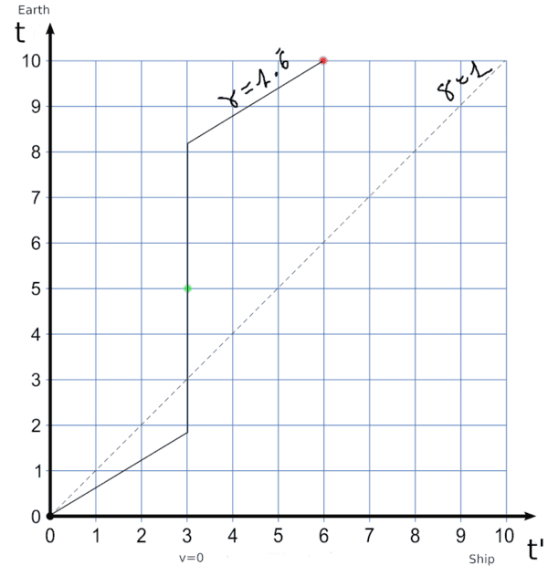

Conventional Twin Paradox. A ship with speed v = 0.8c makes a round trip from Earth and back. It lasts 6 years and on earth 10 years have passed.
The ship carries its own clock and also a computerized clock that always shows the time on earth at that moment.
It is about knowing the T - T' graph that the computer clock in the ship shows during the trip. The events to follow are (t,x=0), the ticks of the clock in earth frame, which must have coordinates in any other frame.
In the simplified problem, instantaneous accelerations, with SR calculations, the graph could look like this:

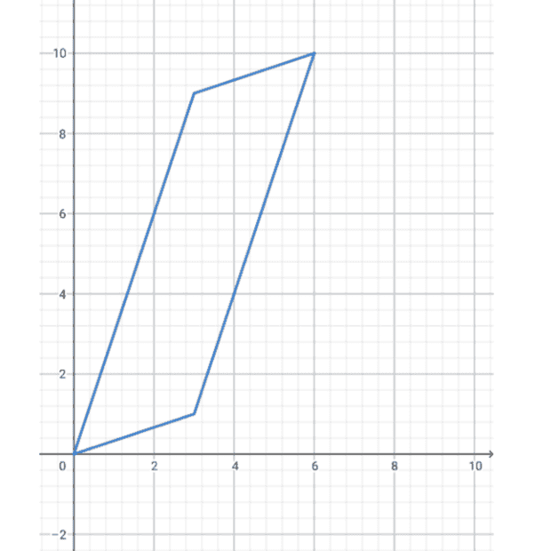

Spacetime diagram with Earth time t on the vertical axis and ship time t' on the horizontal axis, showing a ship worldline going out and back with a vertical segment at t' = 3 and a dashed line of slope 1.
This graph represents several problems for me. One is the temporary discontinuity in the middle of the trip. The computerized clock that shows the time on earth would instantly change from marking about 2 years to marking about 8. And also this depends of pilot deciding to return. if he decides to continue flying away from Earth the computerized clock should not jump. All of this seems unphysical.

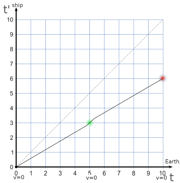

So I try to think of a more realistic graph, which takes into account the accelerations and following assumptions:
1. Every event, the ticks of the clock on earth, must have coordinates in other frames and its evolution must present continuity.
2. The accelerations (start, stop, return, stop) are symmetrical and must contribute equally to the graph.
And it seems to me that a realistic graph, with physical sense, should be like this.
Spacetime diagram of a round trip, Earth time t against ship time t', both axes 0 to 10; a blue curve with steep acceleration segments, labelled with slopes and a dashed line t = t'.
During the accelerations the slope is greater than 1. This indicates that the ship sees in the computerized clock that the time on earth is increasing very fast during the acceleration. This seems to be in accordance with GR equivalence principle. An acceleration, like a gravitational field, objectively slows down clocks.
When the ship is already going at a constant speed, the slope is less than 1. This indicates that it sees dilation in terrestrial time according to the Lorentz transformation.
When it stops halfway, the slope is 1 and the terrestrial clock follows the same rate.
However, according to SR, the acceleration does not influence, only the path and speed, and therefore there can be no slopes greater than 1 in this graph.
So I don't understand which of my assumptions is wrong. I would like to know what would be the right, realistic T-T' graph, the computerized clok in ship, in the twins paradox.

In which frame is “at that moment” computed?
Why? Please post your derivation. Or at least the calculation that the computerized clocks are performing.
Why? Where does this limit come from? Again, show your derivation.
Yes.
The computerized clock on the ship is telling you what the earth clock is reading at the same time that we on the ship are looking at the computerized clock. Relativity of simultaneity (if you are not familiar with that concept, stop right now and learn about it - it is essential) means that the definition of "at the same time" is different depending on the speed of the ship relative to the earth. Changes in that relative speed can can produce large changes in the definition of "at the same time" and therefore large swings in the time displayed by the computerized clock on the ship - the vertical line you see in your first graph is the result of the computer clock switching from the "earth receding at .8c" definition to the "earth approaching at .8c" definition instantaneously.
Obviously that line has a slope greater than 1, but all that means is that our notion of "at the same time" changed instantaneously. If we do a more physically realistic version without the instantaneous acceleration we get a line that's not quite vertical, but its slope can still be much greater than 1 (vertical displacement the same 6-odd years, horizontal displacement much less than that). So your second graph is fine; your assumption that the slope cannot exceed 1 is wrong.
Two further thoughts:
1) You are calling the device on the ship a "computerized clock", but it's not measuring time, it's displaying the results of a moderately complicated calculation starting with the regular clock on the ship as input
2) Google for and read about the "Andromeda Paradox", a somewhat more approachable example of how small changes in relative speed can lead to large changes in the definition of "at the same time" when working with distant objects.
Your graphs both look correct, in special relativity a change in the ship's inertial frames will cause a time jump in "earth time", the fact that acceleration caused it is kind of irrelevant it's the change in inertial frame that matters. It results in a path change and a slope greater than 1.
This is caused by the ship's hyperplane of simultaneity abruptly changing from earth's past to earth's future.
Now realistically a slower acceleration will cause a continuous change in inertial frames, and the Earth clock will speed up (from the ship's perspective) instead of jumping. But the end result is identical.

I don't think the second one is correct at all, unless he's doing something a lot more complex than I think he is. His tick rate initially increases, which isn't consistent with his previous graph at all. And the turnaround ought to produce a much larger shift in the remote clock time than the initial acceleration and final deceleration do, because it produces the same "angle" change in the plane of simultaneity but is much further from Earth than those accelerations. And with a finite acceleration phase he'd have to cruise at above 0.8c to achieve the same overall 6:10 aging ratio.
That's assuming he's doing something like using momentarily comoving inertial frame simultaneity (which additionally has the backwards in time issue I mentioned above).
@LikenTs: a more useful thing to note is that there is no unique answer to "what time is it on Earth". For your original instantaneous acceleration case, see the graph below. Literally any curve that connects (0,0) to (6,10), stays within the blue bounded region, never goes left, and never goes down, is as good as any other. All such curves have the property that, looking through a telescope, Earth will never see the clock "synchronised" like that to be ahead of their own clocks, and nor will the ship ever see the Earth's clocks ahead of their "synchronised" clocks. And all agree on the initial and final times which are the only actual invariants.
(Apologies for lack of labelling - the scales are as per your first graph, with ship time horizontally and time on Earth "now" vertically.)
Graph of Earth time against ship time on x and y axes from 0 to 10, showing a blue bounded parallelogram with vertices at (0,0), (3,1), (6,10) and (3,9).

You must distinguish between proper acceleration of a twin and acceleration of a reference-coordinate system.
  • The proper acceleration of a twin does not influence directly the age difference when both twins meet again.
  • The proper time of the earth twin can also tick faster than the coordinate-time of the accelerated reference frame (rest frame of the space ship). Slopes can be greater than 1 for a non-inertial reference frame.
No. The second graph is wrong with regards to this.
  • The pseudo-gravitational time dilation of the earth-twin in the rest frame of the space ship leads to a slope smaller than 1 at start and the second stop, because in both cases the space ship's rest frame is accelerating away from earth. Additionally, in both cases the pseudo-gravitational time dilation is insignificant because of the small distance between earth and ship.
  • The pseudo-gravitational time dilation of the earth-twin in the rest frame of the space ship leads to a slope greater than 1 at the first stop and return, because in those two cases the ship frame is accelerating towards earth. In those cases, the earth is "above" the ship in the pseudo-gravitational potential.

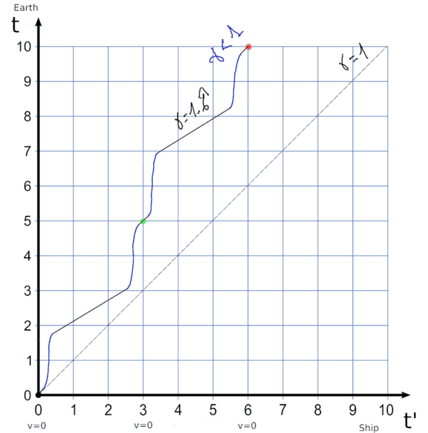

Thanks for the responses and sorry for the delay. I have been studying accelerated frames in SR, to understand the key factor that indicated @Sagittarius A-Star, the importance of the sense of accelerations and dependence on distance.
So, this would be roughly the earth display clock on the ship, with non-instantaneous accelerations. The accelerations that matter are the far ones.
Graph 1
Spacetime diagram titled Earth star 1, with t on the vertical axis and t' (Ship) on the horizontal axis, both running 0 to 10 on a blue grid. A dashed diagonal line marks the light-like path. A black zigzag worldline runs from the origin to a red point at (6, 10), with a green point near (3, 5) and labels v=0 at the origin, t'=3 and t'=6.

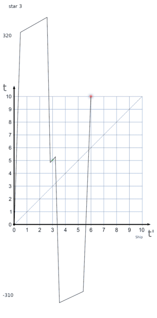

But now comes the most interesting, which @Ibix commented. If we have another third star aligned with Earth and the destination star, but much further away, which has its time synchronized with the earth- and star 2, and the ship also has a clock display to know the time on the star 3, its graph would be
Earth-Star 1 --- 4ly --- Star 2 -- 396 ly -- Star 3
Graph 3
Spacetime diagram with t on the vertical axis and t' on the horizontal axis, showing a ship's worldline as a zigzag path with a dashed diagonal line through the origin, labelled star 3 at top, values 320 and -310 marked on the vertical axis.
That is, during the turn around back to Earth on star 2, the clock display in the ship for the star 3 goes back in time. This is like aborting the trip to the star 3.
So
Corollary 2: If you abort the trip to a destination in space, its time jumps back according to the same DT = L v/c relationship.

@LikenTs all of your graphs seem to be random squiggles with no reason, justification, or explanation. Please answer my previous questions before proceeding.
Earth-Start 1 --- 4ly --- Star 2 -- 396 ly -- Star 3
Graph 3
So
Again this is simply a change of synchronization associated with a change in inertial reference frame.

OK. It was not my intention to enter into trite debates, although from the references that I put above I think that I am not alone in the interpretacion.
My main question, summarized, was the following. We have built the ship. The crew asks for a clock display to always know the time on Earth (According to their simultaneity criteria)
Then the following questions arise.
1. Physicists Academy: That is possible and the function is perfectly defined. Or, it is not possible, it does not make sense, you can choose any function that in the end matches.
2. If 1 affirmative. Is it possible to program this clock display only with a local clock and an accelerometer?, and regardless of the trips that the ship finally makes before returning to Earth and both clocks coincide?. Would graphs 1,2,3 approximately correct?.
If you specify a simultaneity convention then yes it is tautologically possible, although the result may include positive and negative jumps depending on how sensible the criterion is. There are infinite choices of valid simultaneity criterion, most of which will give different answers.
No. You need an accelerometer and at least a memory of all past accelerations (the velocity in the Earth frame before the most recent acceleration will do if we're restricting this to instantaneous accelerations) in order to determine the current velocity and position of Earth in the chosen coordinate system. Acceleration alone won't do.
Suppose you use Einstein synchronization, and the current rate of your synchronised clock is ##1/\gamma(v)##. Then you accelerate such that your speed has changed by ##v##. Is the new clock rate ##1## or ##1/\gamma(v')## where ##v'=2v/(1+v^2/c^2)##? Without knowing the sign of ##v## you can't know if you increased speed or decreased relative to Earth. That information is not held in the clock rate. And I haven't even mentioned the time skip - for that you need to know ##x## as well.
