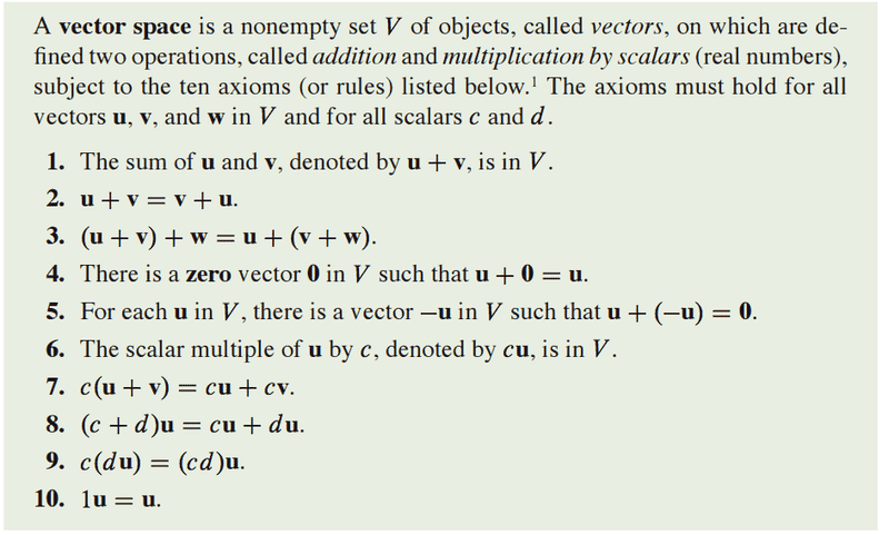

this doesn't feel like enough for me to prove it nor do I know how to prove it on paper.
  • Text box listing the ten vector space axioms: addition closure, commutativity, associativity, zero vector, additive inverses, scalar multiplication closure, distributivity over vector and scalar addition, associativity of scalar multiplication, and 1u = u.
Well, post #13 contains (almost) all what has to be shown (I've forgotten 8-10 in your book's numbering) and post #20 says what it means to be in ##S## or ##V## if you will. However, you are right, the hardest part in this example can be to write down, what apparently is quite obvious. That's why I said it can be seen.
