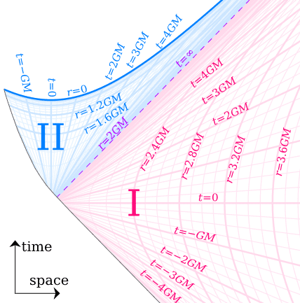

Trying to follow Townsend's notes; section 2.3 is discussing ways of dealing with the co-ordinate singularity at ##r=2M##, i.e. either by transforming to ingoing EF which cover I & II, outgoing EF which cover I & III, or KS which cover the entire manifold.
I got a bit preoccupied with the co-ordinate transformations and I realized just now I don't really understand the big picture. How are you supposed to interpret region III, the white-hole interior region? He says "both black and white holes are allowed by GR", but both regions are part of the same spacetime, right? While we're at it, what's the significance of having two exterior regions?
In other words, I think I misunderstand what these diagrams are supposed to mean. Could someone clarify? Thanks :smile:

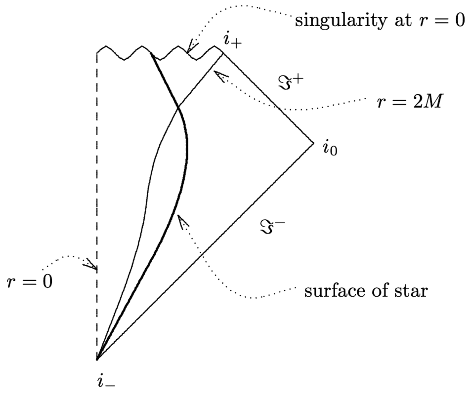

In the real universe, black holes come into existence by a collapse of matter. Schwarzschild coordinates, or any transformation of them e.g. Kruskal coordinates, are valid only outside, or after, the collapsing matter.
In a Kruskal diagram, the outermost piece of collapsing matter forms a timelike worldline in regions I and II, so the chart is only valid above or to the right of this timelike path. Below and left of the worldline, a different metric would apply, so regions III and IV wouldn't exist.
There's a diagram I once drew here: https://www.physicsforums.com/threads/oppenheimer-snyder-model-of-star-collapse.651362/post-4164435
The maximally extended spacetime represents something that, as far as we can tell, couldn't exist in our universe.
The Kruskal diagram covers the whole of spacetime, and there are four regions. Two are the exterior and interior of the hole. The other two are another exterior and a white hole region, but they are artefacts of taking the notion of an eternal black hole a bit too seriously. It reminds me of modelling the Earth as a point mass in Newtonian gravity and concluding that there's a singularity at the centre - we've taken our idealisation a little too far. Chapter 7 of Carroll's notes has a sketch of spacetime including a collapsing star, which doesn't include those other two regions.

Interesting! I read the articles now, think it's making a bit more sense. So the collapsing matter case is not time-symmetric and it follows we can pretty much ignore regions III and IV (or, stronger, anything below and left of the timelike worldline of the outer-most piece of the collapsing matter...). That's what this diagram is trying to show, right?
