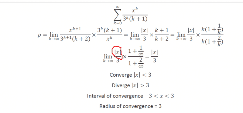

why we need to make x as absolute value ? as we can see, the original is x , why we we need to make x as absolute value ? is the working wrong ?

Look one line up from where you put the circle to see where it comes from.
What happens to the limit when x is a negative number, and you don't have the absolute value?

Ya, it come from the top. But, why would we need to put iy as absolute value?
Because if you don't the possibility that x may be negative will give you the wrong limit. Try it and see:

It's using the ratio test. This looks at ##\lim_{k \rightarrow \infty} | \frac{a_{k+1}}{a_k}|##
The modulus should be introduced at the start, not arbitrarily half way through the calculation.

taking x=-4 , k =2 , the term is -16/27
taking x=4 , k=2 the term is 16/27 , i couldn't find out why there is a need to put modulus ?
It's not what happens to the term, it's what happens to the limit.

what will happen to the limit ? i really have no idea...

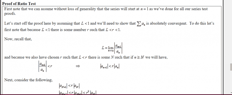

well, for this part of the notes, why do we need to make r is between L and 1 , and we take r is larger than L at the lower part ... isn't the L itself is the factor r ?

No , L doesn't necessarily satisfy ##| \frac{a_{k+1}}{a_k}| \leq L## for k sufficiently large.
Any r with ##L<r<1## does satisfy ##| \frac{a_{k+1}}{a_k}| \leq r## for k sufficiently large.
As an example, take ##0<L<1##, and define ##(a_n)_n## by:
##a_1=1,\ a_{n+1}=a_n(L+\frac{1}{n})##
Then ##|\frac{a_{n+1}}{a_n}|=L+\frac{1}{n} > L##, but ##\displaystyle \lim_{n\rightarrow +\infty} |\frac{a_{n+1}}{a_n}| =L##.

If ##L = \lim_{n \to \infty} |a_{n+1}/a_n|## then, for any (small) ##\epsilon > 0## we have ##(L-\epsilon) |a_n| < |a_{n+1}| < (L+\epsilon) |a_n|## for all ##n## sufficiently large; essentially, that is the definition of the limit above. We simply cannot conclude that ##|a_{n+1}| \leq L |a_n|##, and in fact, you can construct examples where this is false.

can you give example for the explanation above ?

The example in post 11 illustrates ##|\frac{a_{n+1}}{a_n}|>L## for each n, while ##\displaystyle \lim_{n\rightarrow +\infty} |\frac{a_{n+1}}{a_n}| =L##.

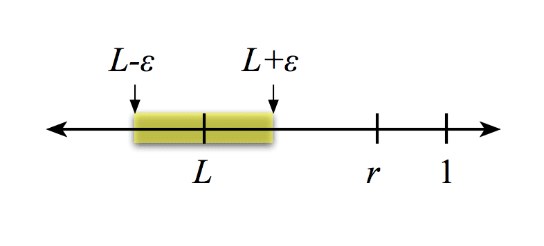

Maybe a picture will help. When you say ##\lim_{n\to\infty}\left\lvert \frac{a_{n+1}}{a_n} \right\rvert = L##, it means when ##n## is sufficiently large, ##\left\lvert \frac{a_{n+1}}{a_n} \right\rvert## will be within ##\varepsilon## of ##L##, where we can choose ##\varepsilon>0## arbitrarily. In the picture, that means the terms of the sequence will lie in the green part of the number line. While the terms are close to ##L##, they could be greater than or less than ##L##, so the limit doesn't guarantee that ##\left\lvert \frac{a_{n+1}}{a_n} \right\rvert<L##. However, since ##r>L##, there's some room between ##r## and ##L##, so we can choose ##\varepsilon## such that we can guarantee that ##\left\lvert \frac{a_{n+1}}{a_n} \right\rvert < r## for ##n## sufficiently large.
what is the purpose of not making L =r , but make L less than r ? isn't the L is the factor = r ?
A proof is an argument, so you're essentially asking, why don't you argue it this way instead. So why don't you try finishing the proof with ##r## set equal to ##L##? You'll see it won't work.
