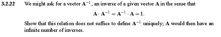

I have an exercise which says to show that for vectors, $ A \cdot A^{-1} = A^{-1} \cdot A = I $ does NOT define $ A^{-1}$ uniquely.
But, let's assume there are at least 2 of $ A^{-1} = B, C$
Then $ A \cdot B = I = A \cdot C , \therefore BAB = BAC, \therefore B=C$, therefore $ A^{-1}$ is unique? (got lazy with dots)

I had what ILS suggests in mind, but I found the question hard to follow myself, hoping this is helpful - it is exactly as follows:
As the dot product is commutative, the fact that $A\cdot A^{-1}=A^{-1}\cdot A$ is superfluous. Choose
$$A=\begin{bmatrix}1 \\ -1\end{bmatrix}.$$
Choose
$$B=\begin{bmatrix}1 \\ 0\end{bmatrix} \qquad \text{and} \qquad C=\begin{bmatrix}2 \\ 1\end{bmatrix}.$$
Then $A\cdot B=1$ and $A\cdot C=1$, but $B\not=C$.
