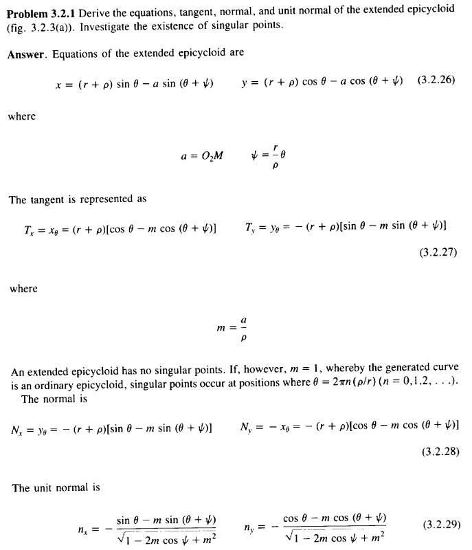

Hi Folks,
I got stuck towards the end where it ask to derive the unit normal. I don't know how they arrived at n_x. I have looked at trig identities...
n_x=\frac{N_x}{|N_x|}=
1) I don't see the (r+p) term anywhere in neither the top nor bottom.
2) Is the bottom just based on simple trig identities? Wolfram didnt simply the denominator
simplify '('sin A -m sin'('A'+'B')'')''^'2 - Wolfram|Alpha

Hi bugatti79,
The $r+\rho$ term cancels upon dividing $N_x$ by the length $|N|=\sqrt{|N_x|^2+|N_y|^2}$.
As for the second part, Pythagorean and sum-difference identities establish the equality:
$({\sin(\theta)-{m}{\sin(\theta+\psi)}})^2+({\cos(\theta)-{m}{\cos(\theta+\psi)}})^2=1-2{m}{\cos(\psi)}+m^2$
