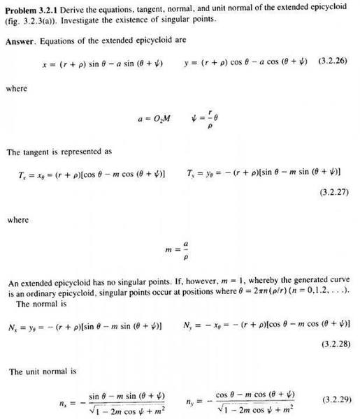

Hi Folks,
I got stuck towards the end where it ask to derive the unit normal (eqn 3.2.29 I don't know how they arrived at n_x. I have looked at trig identities...and I have assumed the following
n_x=\frac{N_x}{|N_x|}
I don't see the (r+p) term anywhere in neither the top nor bottom.
PS: I have posted this in MHB on Tues but no response.
http://mathhelpboards.com/calculus-10/unit-normal-epicycloid-16922.html
Thanks

The norm of the normal vector is ##|\mathbf{N}| = \sqrt{ N_x^2 + N_y^2 }##. The unit normal is ##\mathbf{n} = \mathbf{N}/ |\mathbf{N}|##, so
$$ n_x = \frac{ N_x}{\sqrt{N_x^2 + N_y^2}}.$$
In particular, there are common factors of ##r+\rho## in the numerator and denominator that cancel out. The rest of the simplification of the denominator can be accomplished with some trig identities.
Ok, great thanks. I should work it out now.
