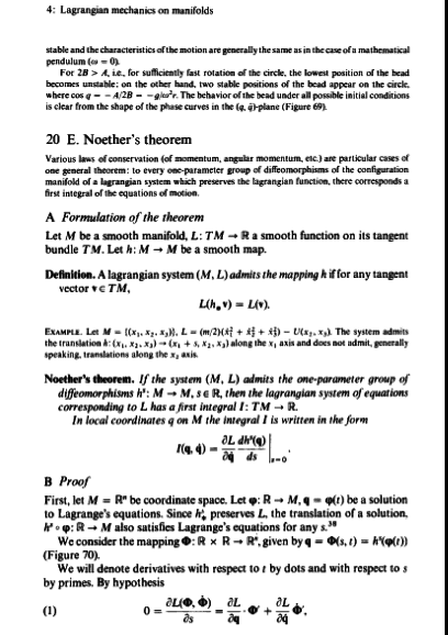

I've included a pic of a section of Arnold's Mathematical Methods of Classical Mechanics. The relevant passage is: "Since [itex]h_*^s[/itex] preserves [itex]L[/itex], the translation of the solution, [itex]h^s\circ \mathbf{\varphi}:\mathbb{R}\rightarrow M[/itex] also satisfies Lagrange's equation for any s."
Maybe Arnold thought it was too obvious to prove, but for whatever reason I'm having trouble seeing why it's true. I tried proving it with chain rule (I was sure the proof will be a simple cal exercise), but to no avail. It's probably really trivial to prove, but my brain doesn't seem to be working. Could someone help?

Attached image is unreadable. I have the book, though, what page is this?
Page 88. What's wrong with the image? Too small?

This is most trivially seen from the principle of least action. h does not change the Lagrangian, so it does not change the functional, so hv is a stationary point if v is stationary.

Yes, thank you! Now it makes sense.
But that said, I'm now left wondering why my (attempted) proof using the Lagrangian directly didn't work. Any ideas?

One problem is that you seem to confuse the formal argument q with a particular trajectory, also denoted by q.
The derivatives Lagrange's equation are taken by the formal argument, but are evaluated at a particular trajectory. The equation should really be written this way: [tex]\left[\frac {\partial L} {\partial q}\right]_{q = Q(t)} - \frac {d}{dt} \left[\frac {\partial L}{d \dot{q}}\right]_{q = Q(t)} = 0[/tex]

I think you could look at variations of q, then the derivatives of L can be represented as limits of variations of L, where you could apply L(hv) = L(v).
