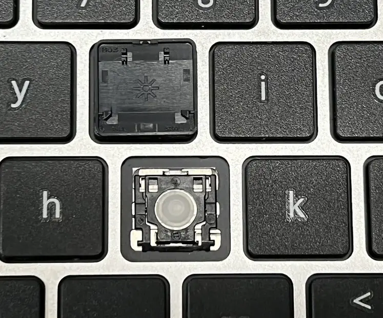

I am looking at other photo of the Asus keyboard. It's not obvious from the photos exactly how the contact is made. For example, this one:
I am not convinced that is a straight electrical contact.
Yes, these are connections I am more familiar with. This one is not like those at all.

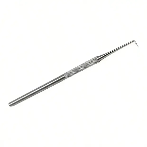

If it was my problem and I needed to get power to it right away, at this point I would be poking around with this tool:
I have some of those.
Be it known here that user .Scott has advised me to poke around in the crannies of my laptop with dental pick tools. 🙃

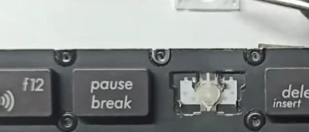

I think a piece is missing there. Without the hinge the base is supposed to look like this:
or:
there is that thin foil (with a wire, I think) across the area, with that rubber pad/cup attached. I think that foil is entirely missing.
Those wires-on-foil things are really hard to find contacts with a needle:frown:

And the tool that I suggested was certainly in the ball park.
There is no wire hinge. I know what those look like, this doesn't have it.
The tactile 'click' is provided by the tiny rectangular knob in the button itself (red arrow post 1).
