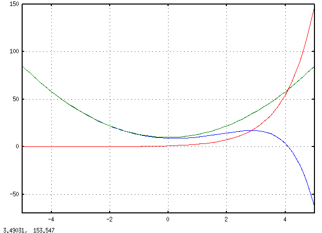

In the attachment, the blue line is the function - the red is the exponential and the green is the quadratic.
With the difference between a quadratic and an exponential, in general, there may be as many as three roots, and as few as none. Do you see how?

The Octave software looks very impressive. It greatly simplifies the whole problem, as it gives a clear overview of the problem and i can almost see the root (it's between 4.0 and 4.5). I am downloading the Windows version and will make it a habit of referring to it for all Newton-Raphson problems.

That plot was generated with:
Code:
x=-5:0.125:5;
y=10+3.*x.^2;
z=exp(x);
plot(x,y-z,x,y,x,z)
grid
This samples the functions at 81 evenly spaced discrete points in the domain [-5,5], and generates a plot linking the dots by lines.
You can zoom in on the root by choosing tighter bounds for x, eg.
x=3.5:0.125/8:4.5;
y=10+3.*x.^2-exp(x);
plot(x,y)
You can also get it to do the N-R calculations for you by putting each step in a loop.

For your function, it takes 5 iterations starting from ans=5 to get the root to 4dp.
Note - there are two turning points? Pick a starting point too close to one of them and it takes quite a long time to converge.
