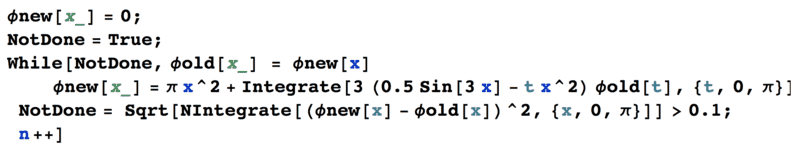

I was able to get the loop to work for some simple iterations, like
Code:
n = 0;
NotDone = True;
While[NotDone,
 \[Phi][x_] = x + n;
 NotDone = Integrate[\[Phi][x] , {x, 0, 1}] < 3;
 n++]
but when I try the real thing what I have is
which I know can't work since I have no way of updating ##\phi old##. Could you help me here?

After setting the new value for NotDone, can you just say that Φold = Φnew ? Then it will use this on the next iteration.

I thought this might work too, but I'm getting a bunch of errors using

Missing semicolons to separate the statements?
Here is the while loop:
Code:
While[NotDone, \[Phi]new[x_] = \[Pi] x^2 +
   Integrate[3 (Sin[3 x]/2 - t x^2) \[Phi]old[t], {t, 0, \[Pi]}];
NotDone =
  Sqrt[Integrate[(\[Phi]new[x] - \[Phi]old[x])^2, {x, 0, \[Pi]}]] >
   0.1; \[Phi]old[x_] = \[Phi]new[x]; n++;]
But your problem is flawed: the sequence ##\{\phi_n\}## does not converge.
