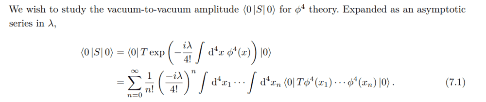

I am not sure how to get the second line from the first.
It looks like he is expanding the exponential as a Taylor series, but what is happening to all those integrals?

Defining the exponential of an operator as a power series, and supposing that the operator ##\int dt H\left(t\right)## exists, what are the first three terms of
$$\exp \left( \int dt H\left(t\right) \right) ?$$
I assume its just this:
This corresponds to the first three terms of the 2nd line in eq. 7.1
I think I see where I went wrong.
Where it says in the 2nd line in 7.1 "..." those only mean measures right? No integrands. So it is only the very last part that is being integrated n times.
That would make sense, am I correct?

I am not quite sure what you mean, as there two instances of "..." in (7.1), one for the integration variables, and one for the integrand. Write the second-order term above as
$$\int dt_1 H\left(t_1\right) \int dt_2 H\left(t_2\right) =\int dt_1 \int dt_2 H\left(t_1\right) H\left(t_2\right) ,$$
so the nth-order term is
$$ \int dt_1 \int dt_2 ... \int dt_n H\left(t_1\right) H\left(t_2\right)... H\left(t_n\right). $$

If ##H\left(t\right)## is a Hamiltonian, what is ##\int dt H\left(t\right)## in terms of a Hamiltonian density?
It is the integral with d^4x of the Hamiltonian density. Just what we have!
