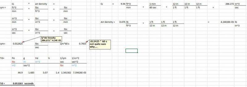

Thanks for your help with this. I was able to calculate the correct answer and follow your method, with the exception of the 60 sec in the 1/qm value. When we calculate qm, we obtain a value of .0124 lbs/sec. If I multiply this by 60 sec, I get .7455. Taking the inverse of this for my final Td equation results in the correct value of Td per the article. But if I multiplied this value by 60 sec., wouldn't I only have lbs as my qm value. Then I wouldn't have any value in seconds for my final Td answer.
So for my Td equation, I have the following:
Td = Pe * g * Ve * k * (1/qm) * (1/vs^2)
Td = 44.9 psi * 1.6885 g * 5.07 in^3 * 1.4 * (1/.7455 lbs) * (1/13524 s^2/in^2)
Td = .053 seconds
I followed your method and put this into excel just as you have and it helped me arrive at the answer (attachment). I'm just a little confused though on the 60 sec calculation and how the seconds still remains for the final Td (time delay) value.
I included the 60 in the seconds conversion was because the original Q was in cfm cubic feet / minute and I was converting it to cubic feet / second in my final conversions. You included a minutes to seconds conversion in your Q conversion before entering it into your final qm equation; and, this resulted in the 60 seconds per minute conversion being duplicated in the calculation. So, your confusion was basically my fault by sticking the 60 value in my otherwise strictly units conversion equation.
Edit: One main problem with the article is that the author was not careful to define all of his symbol units; but, this is not unusual even in published technical books (in that case, often the units are explained once in some paragraph in chapter 2 and you are expected to remember that when trying some example problem in chapter 10) and it really drove me crazy when it happened in my engineering course textbooks.
