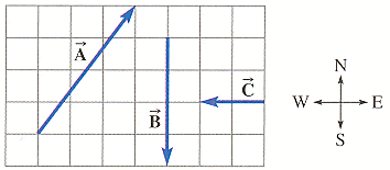

In the drawing below, what is the vector sum of forces vector A + vector B + vector C if each grid square is 12 N on a side?
I have been working at this problem for awhile now and the webassign keeps saying i have the wrong answer. I have one more shot at getting the answer correct. I have two problems like this one and can't seem to figure it out. I know that vector B = 48N, vector C = 24N, and using the pythagorean theorem i found vector A = 60N. Adding all of them up the sum is 132N, that is not correct. I am not sure exactly what to do. I also found the vectors that make up Ax = 36 and Ay = 48. Do i need these to solve the question. Is vector B supposed to be subtracted since it goes in the -y direction, as well as vector C going in the -x direction.
Consider the two directions separately. In the x-direction you have
Ax=36N and C= -24N (Remember, vectors have direction, I chose right as positive)
So what is the resultant of these two?
Then do the same for the y-direction.
Then the Pythagorean theorem will get you A+B+C
The resultant of Ax and C = 12N. That is my x direction. the y component ends up being 0, Ay = 48N and B = -48N. I am not sure where to go from here using the pythagorean theorem.
Right well in that case, the resultant force = R
So you have Rx= +12 N and Ry=0 N. So your resultant is just Rx. Also remember, to put the direction in your final answer.
