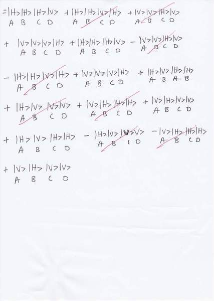

Can you double check your RHS, or is my LHS wrong?
Find attached my right hand side calculation. As far as I can tell, it is correct.
Is there a typo in the book, should it be this?
Psi+(DA)Phi+(BC) = Phi+(AB)Psi+(CD) + Phi-(AB)Psi-(CD) + Psi+(AB)Phi+(CD) - Psi-(AB)Phi-(CD)

Should it be that, if the way to verify the equality is to expand as I have done and cancel like terms, and re-arrange the photons as they're originally entangled?

There is a typo in the answer given by the author:
The answer given in the book is
Expand the left side:
|H>|V>|H>|V> + |V>|H>|H>|H> + |H>|V>|V>|V> + |V>|H>|V>|V>
Phi+ * Psi+ is (HH+VV)(HV+ VH)
The result cannot contain HVHV
StevieTNZ said:
Did you manage to check if your method is correct by verifying that equality?
Yes, seems to work.
An error on my part.
The answer should be |H>|V>|H>|H> + |V>|H>|H>|H> + |H>|V>|V>|V> + |V>|H>|V>|V> for the left hand side.
When i expand the left side, i find
HHHV +VHHH + HVVV + VVVH
the BC terms in the middle are HH and VV they come from Phi+
the other H and V come from the AD Psi+ terms.
Let us verify the equality (i do not write the 1/2 factor)
HHHV + VVVH come from (HH+VV)(HV+VH) + (HH-VV)(HV-VH)
According to the exercise VHHH + HVVV should come from (HV + VH)(HH+VV)+ (HV -VH)(HH-VV)
but they cancel. I think that there is a typo in the LHS of the equality: there must be a minus sign before Psi-Phi-
(HV + VH)(HH+VV) - (HV -VH)(HH-VV) gives the good result.
