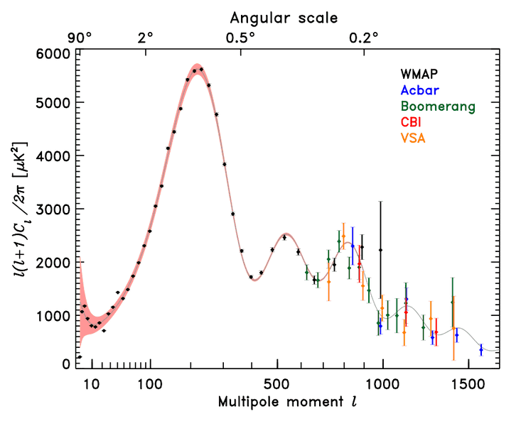

Why is the vertical axis in the CMB power spectrum usually chosen as ##l(l+1)C_l/2\pi## instead of simply ##C_l## ?
The only answer I found come from this post on stackexchange, but the answer doesn't seem very complete. Anyone knows ?
Rennie's first reason often is given as the reason, e.g., page 243 from the book "Modern Cosmology" by Scott Dodelson, and section 4.1 from the article "COSMIC BACKGROUND RADIATION MINI-REVIEW" by Scott and Smoot,
https://arxiv.org/abs/astro-ph/0406567
Rennie's second reason also is plausible.
If the CMB power spectrum were simply a scale-invariant Gaussian random field, then its power spectrum plotted with that vertical axis would be essentially flat (up to variation due to cosmic variance/instrumental noise). I believe the factor ##\ell(\ell+1)## stems from the fact that the spherical harmonics are not strictly flat plane waves.
