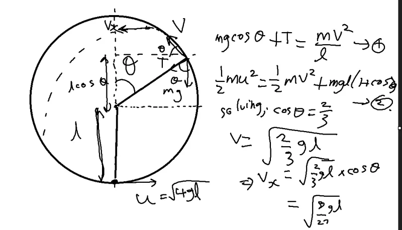

I have tried to proceed with the problem. After some analysis(energy+ FBD) I have found that the string will go slack at exactly ##arccos(2/3) ## from the horizontal. At this point, it would have a horizontal component of speed as ## \sqrt{8gl/27}## (from energy consv. between bottom point and reqd. point). We also know that this horizontal component is not going to change, as there is no external force in the x-direction during the bob's projectile motion.
Also, at the turning point of the bob's motion, it will have only a horizontal component, hence the ans. is option D.
Will post my working soon
Sounds good, even without the calculations.
I think the string goes slack when the angle between the string and the vertical (not the the horizontal) is ##\arccos (\frac 23) ##. The direction of the bob's velocity is then ##\arccos (\frac 23) ## to the horizontal.
Well done!
Edit - typo'
Here is my working:
yes, I meant to say that it is ##\arccos (\frac 23) ## with the horizontal.
thanks for the help
thanks for the help
Your correction repeats the mistake! You mean ##\arccos (\frac 23)## to the vertical - as you correctly show in your diagram.
A general point: it's helpful (to whoever is marking your work) to include few words of explanation. Then, even if you make some arithmetic/algebraic mistake(s), the marker can understand your method and can award some marks. In this question, two key points I would have explicitly stated in my answer are:
a) at some point, the tension in the string will be zero and the bob’s motion will change from circular to parabolic;
b) at the top of the parabolic path, the bob's vertical velocity component will be zero; then the bob's velocity will simply be the (constant) horizontal velocity component of the parabolic motion.
Also, a free-body diagram of the bob is generally recommended - it could help you and might get you marks.
thanks for the help
EDIT- yes, I meant to say that it is ##\arccos (\frac 23) ## with the vertical
