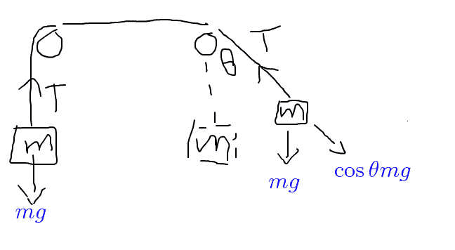

Two equal masses hang on either side of a pulley at the same height from the ground. The mass on the right is given a horizontal speed, then after some time--
(A) The mass on the left will be nearer to ground.
(B) The mass on the right will be nearer to ground.
(C) Both the masses will be at equal distance from the ground.
(D) Nothing can be said regarding their positions.
Just thinking visually, I feel that as the mass on the right moves with a horizontal velocity, the left mass will lift up.
So, answer is B, which is in fact the right answer.
But the masses also feel tension and I just think there must be a more concrete explanation.
Both masses have a net force of zero i.e. the tension = weight.for each a condition of equilibrium and thus there is no acceleration but given a shove ( or impulse) they will move at constant speed depending on the magnitude of that impulse. The masses are out of equilibrium only during the time of the impulse.
look at the scetch
Let's say that the length of the swinging part of the rope is ##r## and we give the right mass a ##{v_0}## speed. Then when it's in the ##\theta## angle position. it will have a speed ##v## such that
##mgr\left( {1 - \cos \theta } \right) + {1 \over 2}mv_0^2 = {1 \over 2}m{v^2}##.
The radial forces on the right body will give
##T - \cos \theta mg = m{{{v^2}} \over r}##.
Now you need to show that ##T > mg##
OOPSS.
The first equation should be
##{1 \over 2}mv_0^2 = {1 \over 2}m{v^2} + mgr\left( {1 - \cos \theta } \right)##
After that corection I will say that it's depand on ##{v_0}##.

In the early stages, both masses will accelerate upwards. The question is (at that point), which acceleration is greater?
Consider the FBDs of the two masses when the right hand string is at some small angle theta to the vertical. What are the vertical forces on each?
I don't understand why the mass on the right side has an acceleration. Is it because theta varies with time and therefore the tension also varies, and the vertical forces are not in equillibrium?

The left hand mass rises, so the tension must exceed mg. The right hand mass experiences the same tension, but, except right at the start, it will not be vertical.
Why does the mass rise ?
This assumes r is constant, which assumes the other mass isn't moving up or down.
Your conservation of energy equation also assumes the other mass isn't moving up or down (you have no term for the other mass's potential energy).
The equations of motion would be:
##F_r=mg\cos\theta - T =m( \ddot r - r\dot \theta ^2)##
##F_{\theta} = -mg\sin\theta = m(r\ddot \theta +2\dot r \dot \theta)##
We can eliminate T by considering the forces on the other mass: ##T-mg=m\ddot r##
These equations can tell you the upwards acceleration of each mass at the initial time, but beyond that they're not very useful unless you know how to solve them (which I certainly don't).If we make the approximation V0<<r, then cosθ ≈ 1 and sinθ ≈ θ which would turn the equations into:
