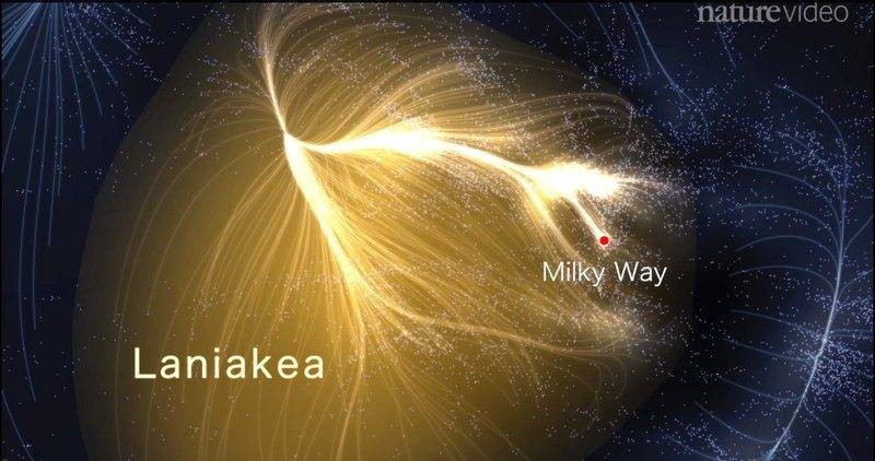

Would the network of Laniakea be revealed before us (depending on our distance of course)?

Take the Andromeda, a typical large, bright galaxy - at 3.5 mag and 2.5 million light years (Mly), it would become invisible at approx. 10-15 Mly*.
A supercluster like Laniakea has an extent of approx. 500 Mly. As long as you're standing farther away than 15 Mly from any galaxy, you'd see complete darkness.

So I think you got your answer. It would be pitch dark.
