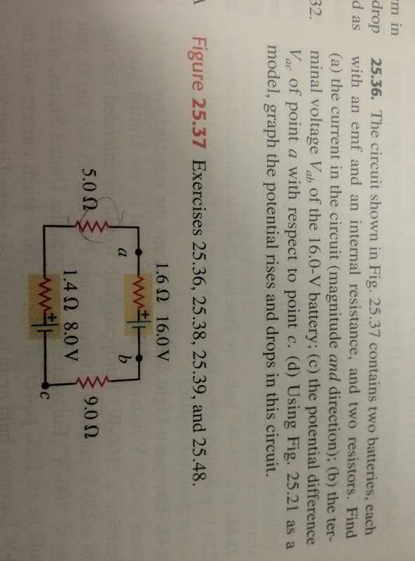

I need someone to explain how to get the answer for (c)
I know its like this (from solution manual)...
Va = Vc + 8 + I(1.4 + 5)
From what it seems, they are just adding voltage in the counter clockwise direction. How are they doing this?
How come I can't add voltage from the clockwise direction?
I am very confused to how this works, I can't seem to grasp an image of what is going in circuits (especially with 2 batteries!) Please explain everything to me.
You can add voltages in either direction you like! You can pick a specific point, say point a, and call that "ground." You can simply declare that point a has zero volts of potential. Then walk the loop, adding the voltages as you go. The sum of all those voltage drops has to equal zero.

Let's write this out a bit more explicitly! I'm going to start with point a, call it zero volts. I'm also going to assume that the current is flowing in the clockwise direction, since that makes it easier for me in my own head.
First, we encounter a resistor. The voltage drop across a resistor is v = R*i. Next, we encounter a battery. The battery maintains a 16V difference between its positive and negative terminals, so, moving clockwise, the voltage drops 16V. Continuing this around this loop, I get:
0 -1.6*i - 16 - 9*i + 8 - 1.4*i - 5*i = 0
Does this make sense so far?

I don't think it's a good idea to change the problem around in the middle of trying to solve it, especially when trying to get help on a forum. That said, the equation should be:
Va + 16 - 1.6i = Vb
In your head, say it like this: "start at point a (with potential Va), add 16 volts, subtract 1.6*i volts, and now arrive at point b (with potential Vb)."
You're trying to start with Va and set it equal to things -- don't do that! You're likely to make sign mistakes. Instead, start with a known voltage (like Va), and add things directly to it as you walk around the loop.

Ok back to the original problem. Va to Vc (Going counter clockwise)
Va - 5I - 1.4I - 8V = Vc
Va - Vc = 8V + 5I + 1.4I
And going from Vc to Va (This is for my understanding, going clockwise)
Vc + 8V - 1.4I - 5I = Va
Vc - Va = -8V +1.4I + 5I
NOW... We go Clockwise:
Va to Vc
Va - 1.6I - 16V - 9I = Vc
Va - Vc = 1.6I + 16V + 9I
Then Vc to Va (Counter Clockwise)
Vc - 9I + 16V - 1.6I = Va
Vc-Va = 9I - 16V + 1.6I
I hope this is not confusing. I tried my best to be clear
I think you're on the right track; can you answer the questions now?
- Warren
Yea the answer is 11V I already know this from the solution. I will check this result with all my equation and see if it is right. Thanks a lot!
Ok so what I figured out is that if you are going AGAINST the current, you need to ADD the IR
So for this equation
Va to Vc
The correct way is
Va to Vc
Va + 1.6I - 16V - 9I = Vc
Va - Vc = -1.6I + 16V - 9I
This yields the correct answer
Hey Instinctlol, the usual practice is to just assume that the current flows either one direction, or the other, at the beginning of the problem. Then you can walk the loop in that direction, adding up voltage drops through all the components. If you end up with a negative value for the current, don't worry -- that just means your initial guess about the current's direction was wrong. No harm, no foul.
