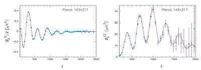

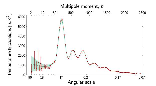

"Still, at the small angular scales, the polarisation data can be trusted and in this data Planck have one of their most impressive figures. The figure below shows how both the temperature multiplied by the polarisation (pixel by pixel on the sky) and how the polarisation itself varies with angular scale. The blue dots are the measured signal. Now, the red curve is not the best fit curve to this data. That is worth pausing and reflecting on. If it isn't the best fit curve, then what is it?
That curve is the unique prediction from analysing Planck's temperature data. There are no free parameters in defining those red lines. Once the temperature data is analysed, we can make an unchangeable prediction for what the polarisation should look like. The fact that the red line goes straight through the blue data points is absolutely remarkable. However, if one believes in the big bang and standard cosmological model, this is all that could have happened. If one doesn't believe in the big bang, then not only is there no reason to suspect that the CMB exists, or that it is polarised, but certainly not that the way the polarisation averages on particular angular scales should look like that.
I think it is worth pausing for one second longer on this. I'm about to start describing a few "features" and anomalies that might be present in the Planck data. It is tempting for a person cynical about natural science to pick up on these anomalies and say "scientists don't understand what they're doing, look at all these anomalies". The thing is, scientists are trying to understand everything. It isn't enough that the model explains almost everything, every possible failure is looked for and analysed. If someone wants to replace the big bang, or any other aspect of cosmology (or well-established science) it isn't enough just to explain how to create these anomalies. Any alternative model must also reproduce everything that works. Without the big bang the prediction for that red line would be a horizontal line through zero. That wouldn't be called an anomaly, that would be called a completely failed model."
Also, to keep in mind besides that alternative models now fail across the line, is that these unacceptable journals by promoting such despite the overwhelming evidence to the contrary will eventually tar humanity and nature both:
"These curves reflect some of the best of humanity. These are the tiny fluctuations in the polarisation of a field of radiation, left over from a hydrogen plasma that permeated the entire universe, 14 billion years ago. The oscillations in the curves come from sound waves in this hydrogen plasma. The curve is our prediction for this data, with no free parameters to play with at all. Just reflect on that. I'm unable to describe how incredible this is. We don't even know whether Shakespeare wrote Shakespeare's plays, but we can predict exactly what the polarisation in the CMB should look like."

I'm no expert but I have read that predictions about or resulting from the CMB involve some six adjustable parameters.
It is quite easy to browse the Planck archive, here the paper about extracting cosmological parameters. They show that 6 parameters, which was best for WMAP, is still best. I.e. the penalty of adding more free parameters is more severe than the success of a better fit.
Now, this is for inflationary LCDM, i.e. it includes inflationary predictions. What I was referencing was that without the HBB, the CMB can't be predicted. Or reversely, you can conclude from the CMB that were was a HBB.

Trobjorn_L,
Your illustration does a good job of showing what LCDM explains so well.

Torbjorn_L said:
Q
You need to elaborate on this comment. The temperature power spectrum is based on some model with tunable parameters. Six parameters are the minimum to describe LCDM with a power law spectrum of perturbations.
Of course I could write to Shaun Hotchkiss and ask what he meant exactly. I assumed that he was referring to the LCDM fit, which parameters are locked in by the temperature power law spectrum and then reused in the figure fits of those first 1-2 polarization spectra measurements. (Those that didn't need months of foregrund et cetera cleaning to show cosmological physics.)
Temperature spectra:
[ http://sci.esa.int/planck/51555-pla...ctuations-in-the-cosmic-microwave-background/ ]
Rough polarization spectra:
So I'm uncertain what you are asking for. Is it a confusion with the temperature spectra, and a desire to mention that there are free parameters in the LCDM? Or is it me that is confused?
I didn't realize that this was a quote. In any case, the statement "That curve is the unique prediction from analysing Planck's temperature data. There are no free parameters in defining those red lines." is prima facie incorrect and needs elaboration. If you cannot provide it, I'd suggest not quoting it. It will lead to confusion.
I'm fairly certain it is correct, Hotchkiss is a cosmologist and he reported from a Planck conference, without any of the readers protesting it.
And I did provide elaboration, so you are incorrect claiming that it is open ("if). My elaboration can be incorrect, which was part of my question.
Or as I said, do you want me to write Hotchkiss to get an expert elaboration?
Appealing to authority won't get you very far in these forums -- many of us are professional scientists here.
A gentle suggestion for future posts: if you are going to quote a source as part of a reply to an OP, be able to discuss the content of this quote. Comments like, "well, I could go ask the guy" are absurd and annoying.
Regarding the question at issue, if you mean to say that the LCDM parameters are fixed in the temperature analysis and that the polarization spectra are then determined "for free", of course this is correct -- the spectra depend on the same set of underlying parameters. In other words, there are no parameters in the LCDM that affect the polarization patterns in the CMB that don't also play a role in the generation of temperature anisotropies. Got it.
