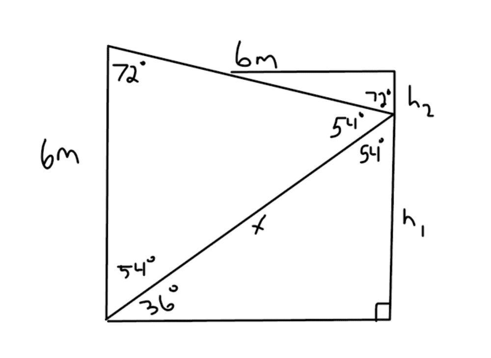

If you calculate the potential energy based on the mass center, you'd have to have some initial potential energy, right?
Initial Energy = 1/2 (2808)( 0.662 √h)2 + (94 kg) (9.8 m/s/s) (3 m) = 615.295 h + 2763.6
I'm having trouble calculating the final height. I drew this diagram, and I used 6 m/sin 54 degrees = x/sin 72 degrees, so x = 7.053. Then h1 = 7.053 sin 36 degrees = 4.146 and h2 = 3 cos 72 degrees = 0.927 total height = 5.072 m?
The rider does not start at a height of 3m before the upswing.
No, but you asked "How far does the mass centre of the rod rise?" If you consider the change in height of the mass center of the rod, instead of the end of the rod as I did previously, you have to account for the fact that the mass center is initially at height R/2 = 3 m. Anyway, the problem gives you the moment of inertia of the rod as being I = 1/3 MR^2, and there is a hint given that says to first calculate the angular speed of rotation of the rider and rod just after the rider grabs on, in terms of the final height the *rider* reaches.
Sure, but you have 94kg in that term, as though the rider also starts at 3m.
