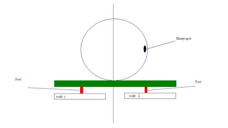

My project is using two digital scales to measure the difference in weight between the top half of the ball compared to the bottom half.
So far I have two digital scales. A board with the center marked to hold the ball inplace. I have feet to put under the board that will touch each scale. After placing scales side by side with the ball directly centered over the two scales on the board I placed the feet 5" from the center of the ball on either side. Everything is centered and balanced. The problem is where the feet are located dictates the amount of force applied to the scale and thus affects the weight shown.
Besides standard trial and error of moving the feet to get the correct distance I was curious how to do this correctly.
I am guessing the formula for torque is involved but that's as far as I've gotten. T= L x F
Further the way this works is I have the heavy spot of the ball facing one scale. Zero out the scales and rotate the heavy spot 180 degrees to the other scale to get the difference marked on both scales.
Thanks for the help.

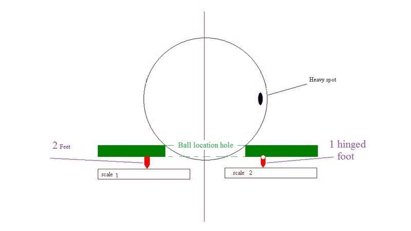

Need a little help visually on the hinge part of this design. Heres a sketch of what I have put together so far.

Redraw attached.

Got it. Just curious what is the point of the hinge?
Thank you
It is a knife edge. It stops the sideways forces on the scales while maintaining the distance between the legs.
It might not be necessary if the top of the scales were free to slide sideways slightly.
