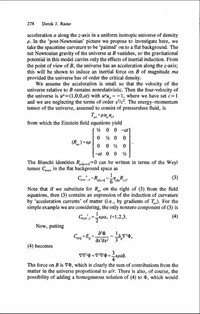

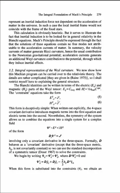

Derek Raine's paper "Integral formulation of Mach's Principle" discusses the concept of Weyl curvature and coordinate transformations. Raine argues that when an observer accelerates and sees the universe accelerate in the opposite direction, real Weyl curvature appears that produces inertial forces. This is a Machian explanation for why you feel forces when you accelerate. However, if we start with zero Weyl tensor everywhere, then the Weyl tensor must stay zero when we change coordinates.
I've been reading Derek Raine's paper "Integral formulation of Mach's Principle" from the book "Mach's Principle" by Barbour, and I've hit something that's really bothering me. It seems like there's a problem in how he treats coordinate transformations and the Weyl tensor.
Here are the relevant passages:
In section 3.1 . "Newtonian inertial induction" Raine considers a test body B accelerating through a uniform universe filled with matter at constant density ##\rho##. He then switches to B's accelerated reference frame. From B's perspective, the entire universe appears to accelerate in the opposite direction. In this frame, the four-velocity of the cosmic fluid becomes ##u^\mu = (1, 0, 0, at)##, which means the energy-momentum tensor ##T_{\mu\nu} = \rho u_\mu u_\nu## picks up off-diagonal components like ##T_{0z} = -\rho at##.
Now Raine claims these time-varying components of ##T_{\mu\nu}## generate non-zero Weyl tensor components through Einstein's equations and the Bianchi identities. He specifically calculates ##C_{0z0,i} = \frac{1}{2}\kappa\rho a## and interprets this as showing that "acceleration currents" produce Weyl curvature, which then causes inertial effects - a Machian explanation for why you feel forces when you accelerate.
However, if we start with zero Weyl tensor everywhere (which we should have in a uniform, isotropic universe), then the Weyl tensor has to stay zero when we change coordinates. That's just basic differential geometry - a tensor that's zero in one coordinate system is zero in all of them. So, how can Raine get non-zero Weyl components just from looking at things from an accelerated frame?
The key equation is the contracted Bianchi identity (Raine uses a linearized version of this):$$\nabla^\delta C_{\alpha\beta\gamma\delta} = 8\pi G\left(\nabla_{[\beta}T_{\alpha]\gamma} - \frac{1}{3}g_{\gamma[\alpha}\nabla_{\beta]}T\right)$$
Those are covariant derivatives on the right side. If the matter is just sitting there uniformly and we're only changing our perspective by accelerating, then ##\nabla_\sigma T_{\mu\nu}## stays zero. The covariant derivative is designed specifically to handle coordinate changes properly - the connection terms compensate for any coordinate acceleration.
What makes this even stranger is that this paper was presented at a conference with many experts in general relativity. It seems odd that such a fundamental error - if it is an error - would go unnoticed. This makes me wonder if I'm missing something subtle about the argument.
To think about this more clearly, I came up with the following thought experiment:
Take two concentric spherical shells with uniform density gas between them, with the same density of the shells. Inside the inner shell, place another smaller spherical shell, and within it a charged test particle kept in equilibrium thanks to, for example, some small charge distributed on the second innermost shell.
Now, physically displace the outer shell slightly. The two bigger shells are no longer concentric, which creates a real uniform gravitational field pointing toward the displaced outer shell's centre. The innermost shell starts to fall, and as it accelerates, it creates frame-dragging effects that "pull" the charge along with it. Clearly, when the innermost shell starts falling, the charge inside will also start falling, but I'm imagining that the charge distribution compensates for this, and that by carefully looking at the mutual influence between this distribution and the charge, it is possible to separate the effect of the uniform gravitational acceleration from the frame dragging effect.
This demonstrates that "turning on" a uniform gravitational field has real, observable physical effects - the charge gets dragged along even though it was initially in equilibrium, and presumably this effect takes a certain amount of time to manifest after the initial configuration has been modified. From the particle's perspective at the centre, this should presumably be the same effect it would experience if everything remained static and the particle itself was accelerating through the innermost shell.
This brings me back to Raine's argument. He's essentially claiming that when an observer accelerates and sees the universe accelerate in the opposite direction, real Weyl curvature appears that produces the inertial forces. My thought experiment shows that uniform fields do produce real effects when they're "turned on", and this should be true both in the case when these fields are due to a redistribution of matter (like in the thought experiment) and when they are a result of a change of coordinates, such as that imposed by Raine, since there is locally no difference between the two.
However, the mathematics of general relativity seems to say these are fundamentally different situations - one produces real curvature, albeit temporarily, the other doesn't.
So where's the resolution? Is there an error in how I'm understanding the Bianchi identities in accelerated frames? Is Raine's "post-Newtonian" approximation introducing artefacts that look like real effects?
I'd appreciate any insights on this. The fact that this was presented at a major conference makes me think there might be something I'm not seeing, but I can't figure out what it is.
I'm not an expert, but that seems sensible. You can't obtain curvature via a coordinate change. The non-zero Weyl component must be a gauge artifact. I imagine he will have spuriously dropped first order terms when trying to linearize the Bianchi identity. If you do it without perturbation theory, or at least make sure to properly expand out and carry all of the first order terms (including the Rindler-frame Christoffels that depend on the acceleration), then you should still get zero Weyl.
Thank you.
Out of curiosity, I attempted to perform the calculation in Rindler coordinates.
It boils down to calculating the antisymmetric derivative of the stress-energy tensor. In these coordinates, the Christoffels are not zero, and unsurprisingly, the derivative is zero in the end.
It seems that he obtained a non-null result only because he used Minkowski coordinates to describe the point of view of the accelerated observer (is that even allowed?) and wrote the 4-velocity of the dust like that, including the "at" term.
I also checked that if one considers the 4 velocity that he writes as if the acceleration was the proper one, then his result is recovered.
