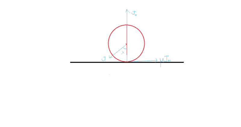

A large sphere rests on a rough horizontal ground,
A ball of mass 'm' is thrown towards it along one of its radius at a speed 'u' , along an angle 'x' with the vertical
Find the angle with the vertical at which the ball should strike (find x) so that the large sphere pure rolls immediately after collision.
coefficient of friction=1
mass of large sphere = 1
radius of large sphere = sqroot(0.4)
During collision impulse will [/B]act in direction perpendicular to the contact surface. As the contact surface is the tangent of the sphere so the acting impulse will pass through the center of the sphere.
As the sphere do not jumps after the collision so ##J_{n}+mg=Jcos(x)##. Now mg is very small as compared to these impulses so I can assume
##J_{n}=Jcos(x)##...(1)
Let ##v## be the velocity of the com of the sphere after collision so
##Jsinx-Jcosx=mv## (value of ##\mu## is 1)...(3)
Angular impulse will only be provided by the friction force.
So ##Jcos(x)R=I_{CoM}\omega##...(4)
As the sphere rolls after collision so ##v=R\omega##
Solving these equations gives wrong answer.Are my equations correct?

Other than that you seem to have switched which mass m refers to (but the masses seem irrelevant), all looks correct to me. Your equations give me ##\arcsin(\frac{7}{\sqrt{53}})##.
Yes that gives ##x=74.05##.
Please clear my doubt. I have considered here the limiting value of the friction(static) but it is not given anywhere in the question to use its limiting value.
Yes, good point. But there's no other way to get answer, is there?

For ball to bounce after collision ##J_{n}>mg+Jcos(x)##. Why did you neglect Jcos(x)?

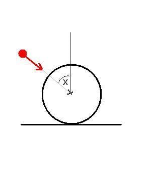

I understood your picture that the ball is thrown from below towards the sphere.
Make it clear please: What are J and Jn?
If the sphere bounces during the time of collision with the ball, it is in the air and is not in contact with the ground.
J is the impulse due to collision of the ball and the sphere and Jn is the impulse which acts on the sphere by the ground.
I am bit confused. First the ball collides with the sphere and then after infinitely small time period the sphere collides with the ground. Then only impulse which is responsible for the bouncing is Jn. right? So the ball would bounce when both collisions have happened.
As the sphere do not jumps after the collision so ##J_n +mg=J\cos(x) ##. Now mg is very small as compared to these impulses so I can assume ...
I am surprised at this. This dimensional inconsistency returns in post #13. ##mg\Delta t## is the term I expected to see, twice. :nb)
The reaction acts at the point where the sphere touches the ground; the cause doesn't. Sum is zero, but there is an angular impulse.
And yes, it can be ignored: m doesn't lie about at the impact point for a long time :)
And no, the sphere doesn't jump: the terminology "pure rolling" excludes that.
The drawing in post #1 let's m come in from the upper right (Ehilds drawing from upper left). The result (74 degrees) doesn't indicate otherwise than that.
What happens to the vertical momentum is slightly mysterious; for me the "rough ground" indicates that it's absorbed.
Having to assume that complicates the exercise in my view: horizontal and vertical asymmetry and then still ask for pure rolling.
