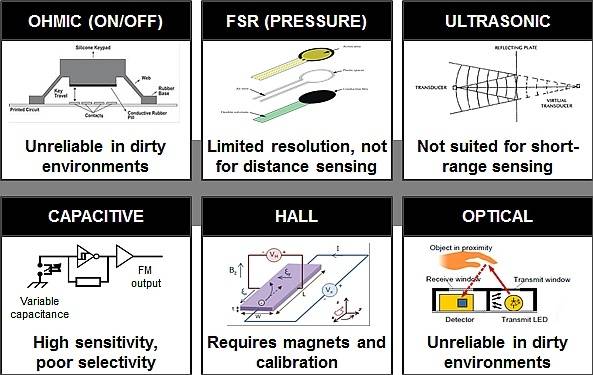

I though this image from the referenced EDN article was interesting from the selling point of view:
