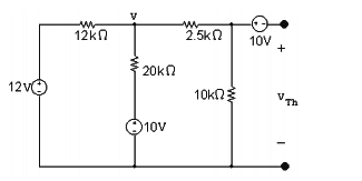

I meant ones with controlled sources, I don't know how to solve those. Also ones like this.
It works if I pretend the 10kΩ isn't part of the circuit, but I'm not sure why that is...
  • Circuit schematic with a 12V source on the left, a 12kΩ resistor, a 20kΩ resistor in series with a 10V source, a 2.5kΩ resistor, a 10V source at the top right, and a 10kΩ resistor on the right branch, with node voltage v and open terminals labeled Vth.
If you pretend that the 10K is not part of the circuit, you cannot possibly get the right Rth, so I suggest your book has a wrong answer or something else is misleading you.

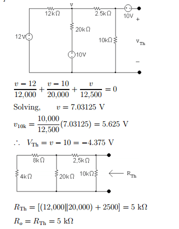

Here's what my book says for Rth, they calculated 12||20 +2.5, and ended up with 5kΩ
  • Handwritten circuit solution: node equation (v-12)/12000 + (v-10)/20000 + v/12500 = 0, solved as v = 7.03125 V, then v10k = 5.625 V and VTh = -4.375 V; below, a resistor network with 8k, 4k, 2.5k, 20k and 10k resistors giving RTh = 5 kΩ.
Why is it not in the equation though? It is because it's parallel to a zero resistor?
Reread post #4. Forget what the book says. Do it right and you'll get the right answer (which is NOT the answer they got, 'cause they didn't do it right).
Why would you think it is parallel with a zero ohm resistor? WHAT zero ohm resistor?
