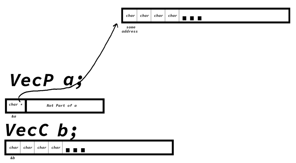

I made an illustration to try and show the difference.
Diagram of two C++ objects: VecP a holds a char pointer to a separate block of four chars and dots, while VecC b stores four chars and dots inline.
This difference will become important when you try to write and read them from disk.

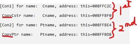

While I was waiting for the reply, I actually modified the program to show the address of all 4 Objects to proof they have different address just like what you drew:

This is the printout:
Console output of a C++ program: two constructor lines and two copy lines printed with object addresses; the first pair (Cname) and second pair (Ptname) are labelled 1st and 2nd, with the copy lines underlined.
You can see the address of the objects are all different, so they are DEEP COPY in both cases.

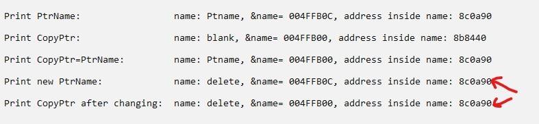

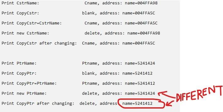

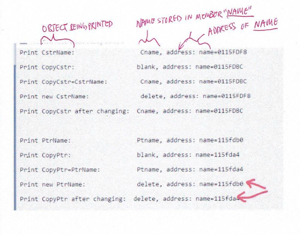

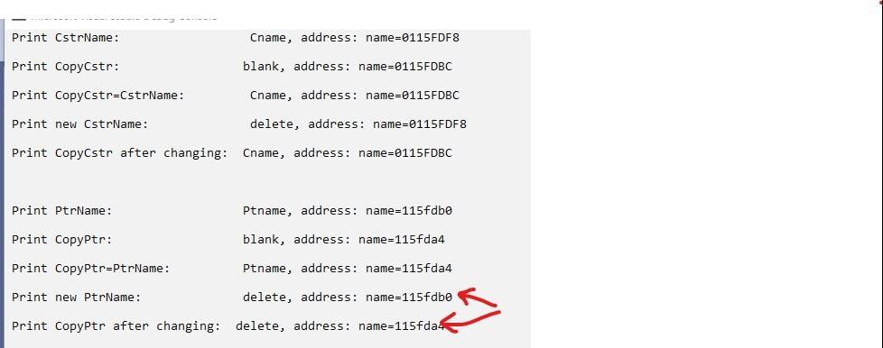

I found the difference between the two. In this situation, using pointer char*name FAILED.
the reason is when using pointer, copying using CopyPtr = PtrName ONLY copied the address name. So when I change the name of PtrName from "PtName" to "delete", it change the name in CopyPtr to "delete".
This is the final program that show this:

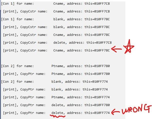

The print out :
Console output of C++ constructor and print calls showing addresses; the line 'CopyCstr name: Cname' is starred and 'CopyPtr name: delete' is marked WRONG in red handwriting.
If you want to, you can run the program, you can see the address of the Objects are correct. Compare the top 7 lines to the bottom 7 lines, the last line is the problem.

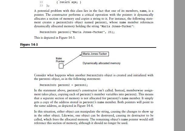

I am very happy, I kept reading using pointer to copy will present a problem in the book, I just cannot put my finger on it till now! I put the explanation in comment in the program. A day well spent for Christmas Eve!

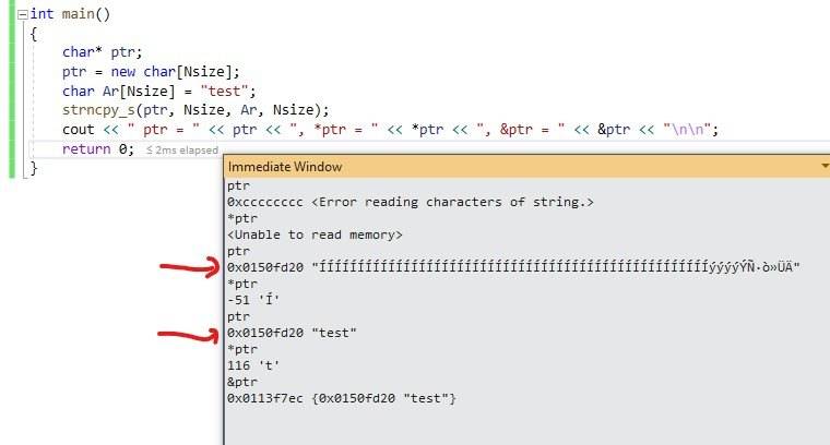

Yes, that's what the book talked about needing the Copy Constructor.I have a question about displaying the pointer, I want to display the ADDRESS it is pointing to but I can't. Here is the short program I just wrote:
C++:
#include <iostream>
#include <cstring>
using namespace std;
const int Nsize = 51;
int main()
    char* ptr;
    ptr = new char[Nsize];
    char Ar[Nsize] = "test";
    strncpy_s(ptr, Nsize, Ar, Nsize);
    count << " ptr = " << ptr << ", *ptr = " << *ptr << ", &ptr = " << &ptr << "\n\n";
    return 0;
When I count << ptr, I got "test", and when I count << *ptr, I got t! &ptr is the address of the ptr, not where it points to. I want to display what is the content the ptr ...which is the address of the memory. How do I do that?
I can only display the address that the pointer is pointing using Immediate window in Debug.
Screenshot of a C++ program in Visual Studio with an Immediate Window showing ptr, *ptr and &ptr values; ptr points to a string displaying 'test' at address 0x0150fd20.
Thanks

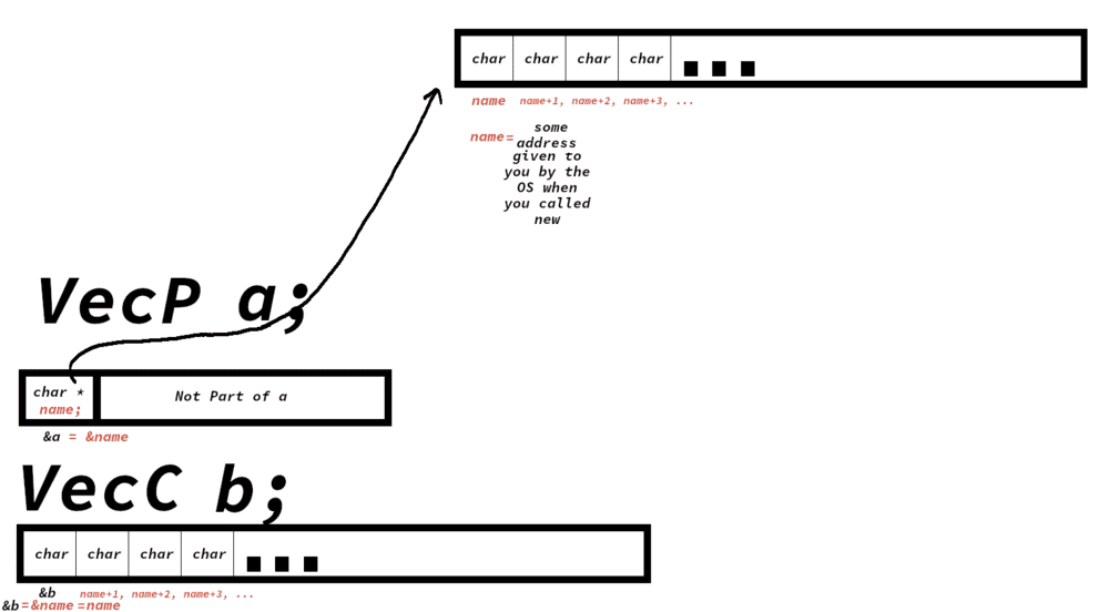

This is because the stream insertion operator, <<, has overloads for char pointers, and for chars. Since the type of ptr is char*, the overload to print a C string is used. Since the type of *ptr is char, the overload to print a single character is used.

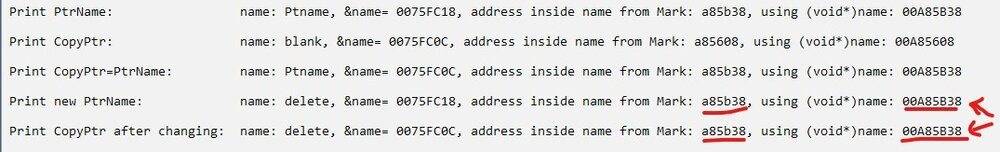

A quick and dirty way would be to cast &ptr as an unsigned int for 32-bit code (which is what you are doing) or as an unsigned long for 64-bit code. For the first suggested, something like this:
count << (unsigned int)&ptr;
There are probably other ways, but this is what comes to mind at the moment.

Hi Mark, Merry Christmas
I tried (unsigned int)&name for pointer name, the address is funny but still address is different between PtrName.name and CopyPtr.name.
Here is the program
C++:
#include <iostream>
#include <cstring>
class vecC {
public:
    char name[Nsize];
    vecC(const char* desc){   strncpy_s(name, Nsize, desc, Nsize); }
    void print() {  count << " " << name <<
        ", address: name=" << &name << "\n\n"; }
    void setName(const char* setC) { strncpy_s(name, Nsize, setC, Nsize); }
class vecP {
public:
    char*name;
    vecP(const char* n) {name = new char[Nsize];strncpy_s(name, Nsize, n, Nsize);}
    void print() { count << " " << (*this).name <<", address: name=" << (unsigned long int)&name << "\n\n"; }
    void setName(const char* setP) { strncpy_s(name, Nsize, setP, Nsize); }
int main()
    vecC CstrName("Cname"); count << " Print CstrName:\t\t "; CstrName.print();//declare CstrName and print out name = Cname
    vecC CopyCstr("blank"); count << " Print CopyCstr:\t \t"; CopyCstr.print();//declare CopyCstr and print out name = blank
    CopyCstr = CstrName; count << " Print CopyCstr=CstrName:\t ";  CopyCstr.print();//Copy CstrName into CopyCstr and print CopyCstr name = Cname
    CstrName.setName("delete");//set name in CstrName = delete
    count << " Print new CstrName:\t\t "; CstrName.print();
    count << " Print CopyCstr after changing: "; CopyCstr.print();//Print out both to see what happen to name in CopyCstr. Works!
    count << "\n\n";
    vecP PtrName("Ptname"); count << " Print PtrName:\t \t\t"; PtrName.print();
    vecP CopyPtr("blank"); count << " Print CopyPtr: \t\t"; CopyPtr.print();
    CopyPtr = PtrName; count << " Print CopyPtr=PtrName: \t"; CopyPtr.print();
    PtrName.setName("delete");
    count << " Print new PtrName: \t\t"; PtrName.print();
    count << " Print CopyPtr after changing: "; CopyPtr.print();//name in CopyPtr got changed to delete because one the address name
                                     //got copied over, so changing the *name change for both.
    return 0;
I put your suggestion in line 17. The number doesn't look right and also you can see it's different from PtrName. The whole point is if you assign a Object with pointer, you copy the address of the pointer that result in both pointing at the same memory location. I don't see that. Here is the printout:
Console output comparing C-string and pointer member copies: CstrName, CopyCstr and PtrName, CopyPtr lines show names and addresses, with a red handwritten DIFFERENT arrow marking the two PtrName and CopyPtr address values.
I think something is still not right using (unsigned long int)&name. Any other suggestion?
Thanks
You're printing the addresses in decimal. It's probably better to print them in hex.
  1. Add #include <iomanip>
  2. Change the print() function as follows:
    C++:
    void print() { count << " " << (*this).name << std::hex << ", address: name=" << (unsigned )&name << "\n\n"; }
Since you are writing 32-bit code, the pointer will fit in a 32-bit type; e.g., unsigned (which is short for unsigned int). You don't need unsigned long (or unsigned long int - same same) for what you're doing.
Hi Mark
I change to what you suggested, it looks better, but the address doesn't match as you can see. For it to be SHALLOW copy, the two has to be the same pointed by the red arrow.
Console output listing pointer names and memory addresses for CstrName, CopyCstr, PtrName and CopyPtr, with red arrows marking the delete lines for PtrName and CopyPtr showing addresses 115fdb0 and 115fda4.
Thanks
You're printing the address of the pointer, not the pointer. You should remove the & before name in the print statement. As shown in the updated diagram, the pointer is contained in a, and its address (&name) is the same as the address of a (&a). But the pointers value (name) holds an address to the string.
Diagram of a class VecP a holding a char* pointer named name, with an arrow from name to a row of four char cells followed by three squares, and a second row of four char cells labelled VecC b with its own address line.
https://ideone.com/Kdd0AJ
  • Diagram of memory layout: a box labelled VecP a holds a char * name pointer with an arrow to a row of four char cells followed by three squares, and VecC b is a row of four char cells then three squares; labels note &a = &name and &b = &name = name.
Jarvis323 said:
You're printing the address of the pointer, not the pointer. You should remove the & before name in the print statement. As shown in the updated diagram. The pointer is contained in a, and its address (&name) is the same as the address of a (&a). But the pointers value (name) holds an address to the string.
https://www.physicsforums.com/attachments/275125
I know what you mean, I did try printing name, that is the most logical way of doing it. It did NOT work. It only print out the the "name"!
I even try to print *(&ptr) which is literally the dereferencing of the address of ptr! and still won't work!
C++:
#include <iostream>
#include <cstring>
int main()
    char* ptr;
    count << " ptr = " << *(&ptr) << ", *ptr = " << *ptr << ", &ptr = " << &ptr << "\n\n";
    return 0;
I don't know what else to do. In order to proof it is SHALLOW COPY, both pointer name have to be pointing to the same memory location.
Thanks

count << name will only give me the name of the Object. I know exactly what you are getting. If name is a pointer, then the CONTENT in &name contain the address of the location it is pointing to. But if you do count << name, you literally get the NAME of the object!
The way I display is the most helpful already. The left most Print follow by the name of the object. then show what is in the name. then the address of name. It's logical if you stop and read it. This tells you what Object is being worked on, what is the string literal stored in name, and then what is the ADDRESS of name!
Here is the printout. This is as good as it gets!
Handwritten annotated printout of console output comparing a C-string copy and a pointer copy, with red labels and arrows marking the object name, stored name, and address of name.
yungman said:
cout << name will only give me the name of the Object. I know exactly what you are getting. If name is a pointer, then the CONTENT in &name contain the address of the location it is pointing to. But if you do cout << name, you literally get the NAME of the object!

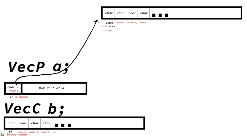

Look at the last version of the diagram I made carefully. name itself is a pointer (address). &name is a pointer to a pointer. I made a sample program that goes with the diagram, if this helps.
https://ideone.com/Y22Kbr

I did everything that is suggested already. What you show early on is only one that gave an address, but it showed it's different, so that it doesn't proof what the book said that both the names of PtrName and CopyPtr point to the same location.
I am trying to proof what the book said. The result is correct, but I cannot proof both pointing to the same location that cause the problem.

Here are the two pages I want to proof, that both name pointing to the same location.
  • Book page diagram, Figure 14-3: a Name Pointer box with an arrow to a box reading "Maria Jones-Tucker" labelled Dynamically allocated memory.
  • Figure 14-4 from a C++ textbook: diagram of person1's and person2's name pointers both pointing to the dynamically allocated memory holding Maria Jones-Tucker, with explanatory text on copy constructors below.
They are different because you have a bug in your code, and this has already been pointed out by @Jarvis323.
You had this in the body of your print() function:
C++:
count << " " << name << std::hex << ", address: name=" << (unsigned long)&name << "\n";
Remove the & in front of name.

I followed what you gave in post 17 to have the &. I really don't understand this.
Ha ha, I am balancing my Christmas party and here!
OK, I put in separate post as this one from Mark actually gives me same address for both as shown. This is what I want to see. I use last thing Mark suggested without &:
C++:
    void print() { count << "name: " << name <<  ", &name= " << &name  <<
        ", address inside name: " <<  std::hex <<(unsigned long)name << "\n\n"; }
the result is:
Console output listing five lines of pointer printouts: PtrName and CopyPtr, each with name, &name and address values; the last two lines have arrows pointing to the identical address 8c0a90.
This is from Mark's last suggestion without &. This is what I am looking, that the last two address in name is the SAME! IF this is correct, that shows the address of name is the same in PtrName and CopyPtr. Then changing name in PtrName will change CopyPtr.
Good morning.
I was searching online to find how to display the address the pointer pointing to. The other way is:
count << (void*)name;. I work also. This confirm the result:
C++:
        ", address inside name from Mark: "<< std::hex  << (unsigned long)name <<
        ", using (void*)name: " << (void*)name << "\n\n"; }
Console output lines printing name, &name and the cast address of a char pointer, with the hex addresses for name and (void*)name underlined and arrowed to show they match.
You can see both Mark's and the (void*)name produce the same address. This concludes this thread.
