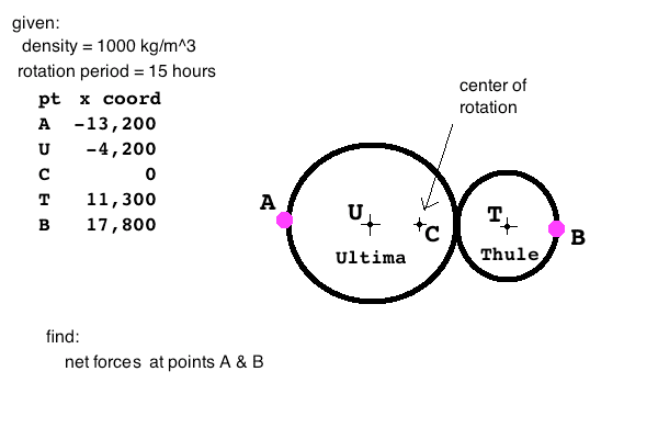

A Kuiper Belt object, Ultima Thule, rotates once every 15 hours.
It has an estimated density of 1000 kg/m^3.
Ultima, the larger sphere, has a radius of 9000 meters.
Thule, the smaller sphere, has a radius of 6500 meters.
The center of rotation is 4200 meters from the center of Ultima.
G = 6.674E-11 m^3⋅kg−1⋅s−2
a. Find the net forces at the extreme points, A & B. Express the answers as acceleration.
b. Find the ratio of the gravitational to centrifugal forces
x coordinates are in meters

ps. This is not real homework, so there is no answer in the back of the book. I normally wouldn't post such a trivial problem, but I've gotten indications from 2 different people that my answers may not be correct.
Looks good. The approach is fine and all numbers I checked are fine as well.
Quick cross-check: For a sphere with the density of Earth the critical rotation period (centrifugal force = gravity) would be 1.5 hours, the period of a low Earth orbit. 15 hours gives you a safety factor of 100. The density is a factor 5 lower here so our factor goes down to 20. The non-spherical shape removes mass, which makes the factor go down a bit more.

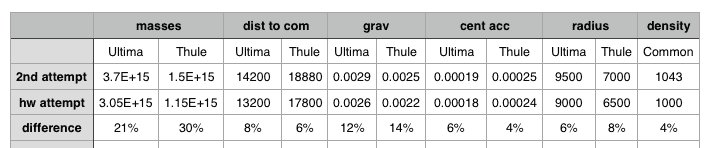

I said your previous answers were not correct but the distances you are now using look good to me.
Seems I'd picked up a false idea about inv. sqr law near to a spherical object. The fact it is exact is quite neat.
Using the masses you calculate, the barycentre distance estimate is 4244km but I'm guessing that NASA have derived their value from observations.
BC_U = ( rT+rU ) * mT / (mT + mU) = 4244km
I actually don't remember that.
That's strange, as all of the number changed, but the answers look consistent with the changes, so my guess is that my original calculations were also correct.
I've not seen a value posted by NASA. Like you, I calculated the center of mass from the given numbers.
Doh! I see I forgot that comparison.
Distance of center of mass to center of Ultima:
2nd attempt 4700m
hw attempt 4200m
difference: 12%​
