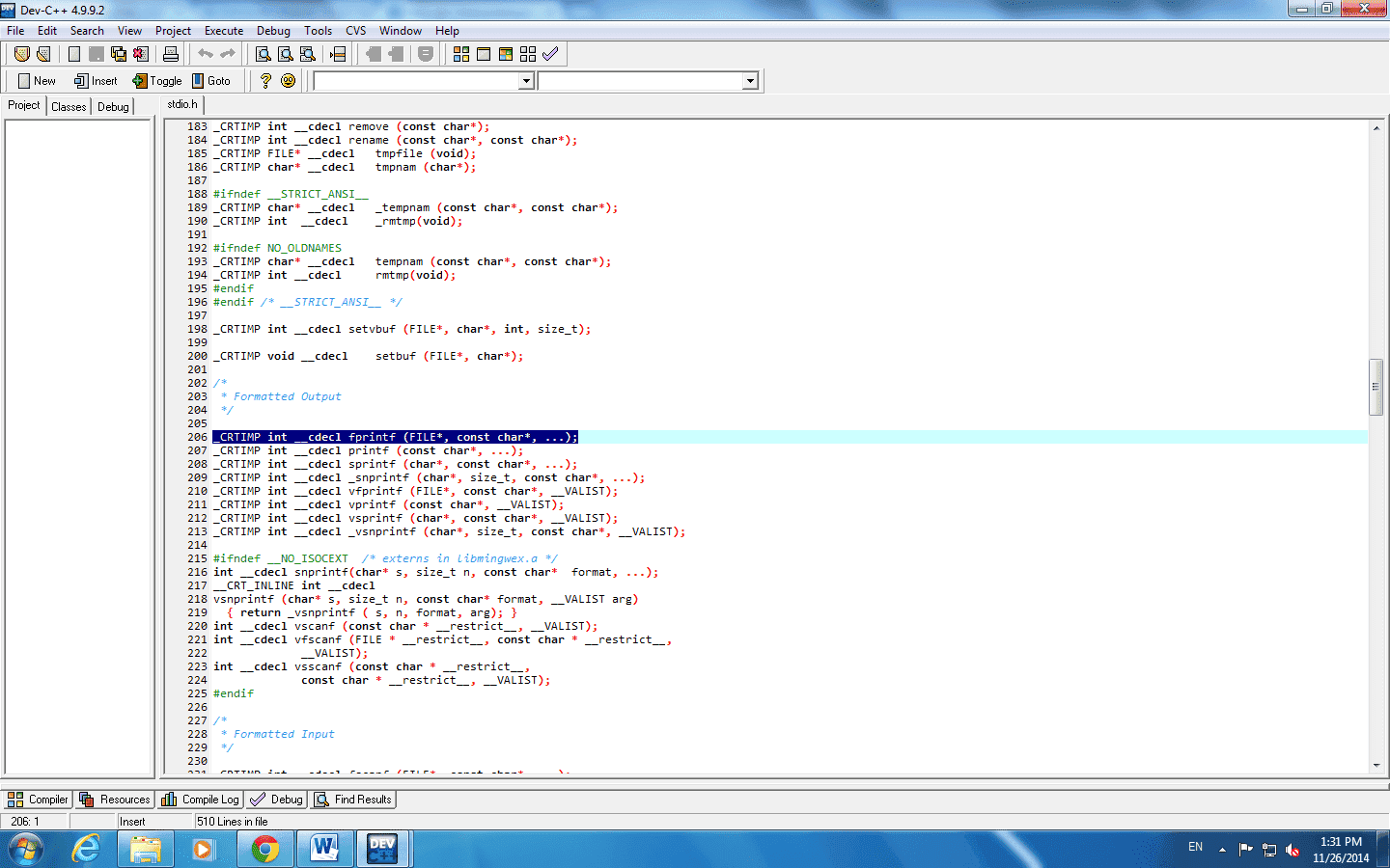

What are the parameters for the printf function in the C language?

My question is that what is the printf function parameters since the number of parameters isn't specified? "I can input as much parameters as I want"I mean what is the prototype of the printf function or its definition ?
I have opened include library ,which printf function is included , but I found that there is three dots "..." what is that refers to
look at the picture of printf prototype!
Could anyone explain!View attachment 3607
  • Dev-C++ editor showing stdio.h around lines 183-231, with line 206 highlighted: _CRTIMP int __cdecl fprintf (FILE*, const char*, ...); followed by the printf, sprintf and vprintf declarations.
These types of functions are called variadic functions, because they have variable arity (vari-adic), and as you guessed, they exist to allow the caller to pass as many arguments as it wants to the function. The ellipsis (three dots "...") is the syntax used to denote a variadic function. For an example on how to use variadic functions, see this link. For instance, here is a variadic function (from the previous link) which takes a list of integers as arguments and returns their sum:

Note the first argument "count" to the function is the number of arguments that follow. This is because it's not possible for the function to deduce on its own the number of arguments that were passed. That information must be passed to the function separately, usually through a first required argument (here a "count" variable, for the printf family of functions this is derived through the number of format specifiers %s, %d, etc.. in the format string). The function also obviously does not know the type of its variadic arguments, which must either be known at compile-time or, again, passed separately (in this example, they are all assumed to be int, for printf the function looks at the format specifiers: %s for a string, %d for an int, etc.).
Also, due to C's syntax, at least one required argument must precede the ellipsis, so you cannot have "purely" variadic functions like "int foo(...);" in standard C. This is usually not a problem, as a purely variadic function does not seem very useful at first glance.
