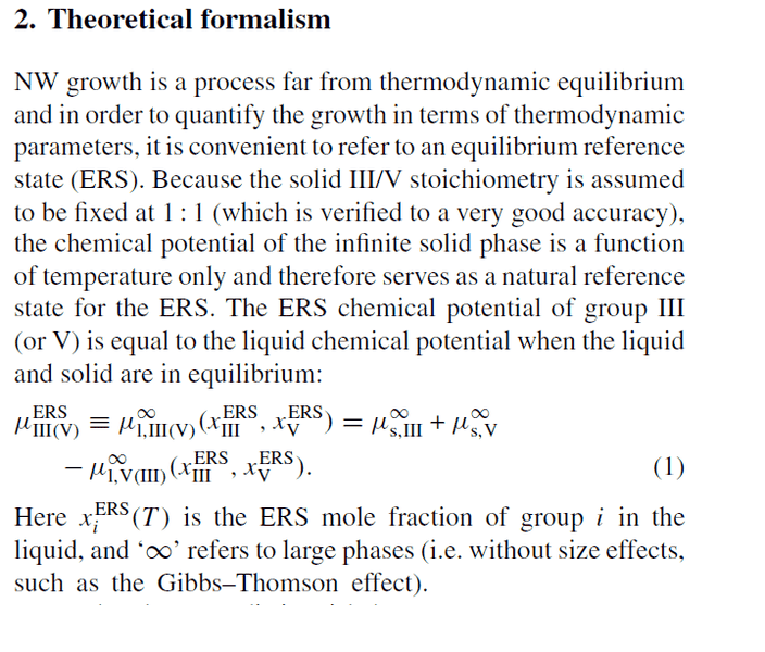

Okay thank you. You have been very helpful. I am now starting to read about the basic thermodynamical theory behind (III/V)-nanowire growth which I think refers to growth of nanowires of atoms from group (III) and (V), e.g. GaAs.
But the general ideas are giving me some trouble. I have attached a few lines, which I hope you might be able to help me understand.
Can you explain to me what is the basic idea of this section? I have some trouble understanding it, maybe because I am not really sure how to interpret chemical potential. The most fruitful definition of the chemical potential for me is the energy required to add another particle to the system.
So what is it that is used as an equilibrium reference (and what does this mean exactly?) - is it the solid. I should expect so since the solid is practically infinite and thus its chemical potential doesn't change as the growth proceeds (apart from if the temperature changes).
But how do they arrive at the condition of the last equality?
