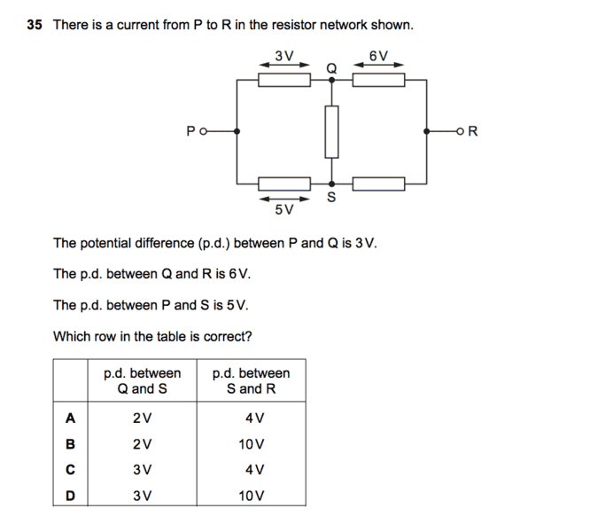

Hey guys, here is a question that I have trouble with, it is a past paper question in the AS physics syllabus
/Users/peterrong/Desktop/Screen Shot 2017-10-10 at 3.57.12 PM.png
I have attempted using kirchhoff's laws, but the question seemed to be missing some datas, please help:)

Here is the question

Yes, and the question wants you to find that missing data. To start, what is the potential difference between P and R?

Ehhh I'm thinking 3V+6V+5V+SR

The two top resistors connect P and R, so the potential difference between P and R must be the sum of the difference across those two resistors.

Right so that leads to 4v on the bottom unknown resistor. Also shouldn't the middle resistor be taking into consideration when calculating the voltage across PR, or you can just ignore it in a question of this kind?

The middle resistor is not dropping any voltage between P and R, so it is ignored at this point.

So what are you supposed to do after finding the 4V drop at the bottom?

You need the difference between Q and S. If you consider P to be at zero volts for simplicity, then it should be obvious what the voltage at Q is and what the voltage at S is.
Wow thank you so much, it seemed to obvious when I made P 0V.
