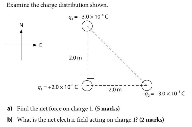

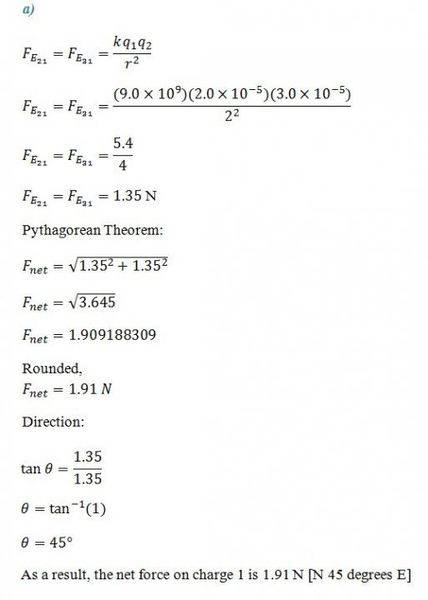

a) Find the net force on charge 1.

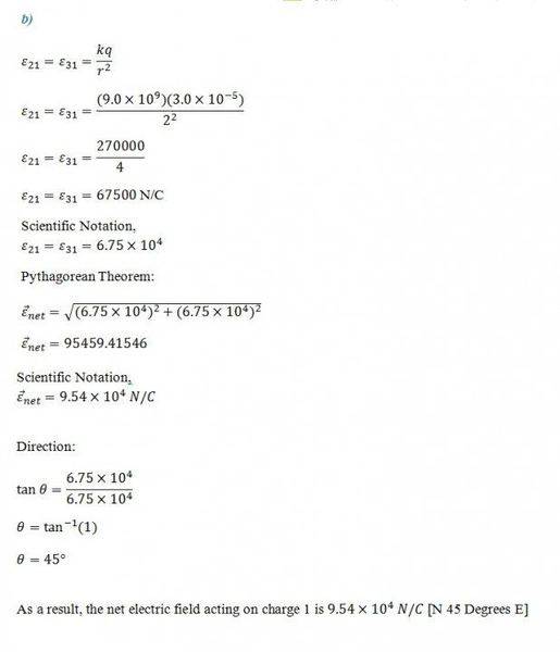

b) What is the net electric field acting on charge 1?
Please see the attached files to view the image that goes with the questions above.
I'm having trouble with this unit in general and I'm not to confident in these answers. I was wondering if someone can review my work?
Please see attached files
  • Diagram of three charges in a right triangle: q1 = +2.0 × 10⁻⁵ C at the right-angle corner, q3 = −3.0 × 10⁻⁵ C 2.0 m directly above it, q2 = −3.0 × 10⁻⁵ C 2.0 m to its right, with a compass showing N up and E right.

  • Handwritten-style worked solution for net electric force on charge 1: Coulomb's law terms for F21 and F31 with values 9.0 x 10^9, 2.0 x 10^-5, 3.0 x 10^-5, r = 2, giving 1.35 N each; Pythagorean sum gives Fnet = 1.91 N at 45 degrees.

  • Handwritten worked solution for part b: field from charges 2 and 3 computed as kq/r^2 = 67500 N/C each, combined by Pythagorean theorem to 9.54 x 10^4 N/C at 45 degrees, N 45 Degrees E.
You could have saved a lot of work on part b. Once you have the force all you have to get the field is divide by the charge.
ShayanJ said:
Yeah, its correct.
Ahh that's good to know!
Thank you guys so much for the help!
