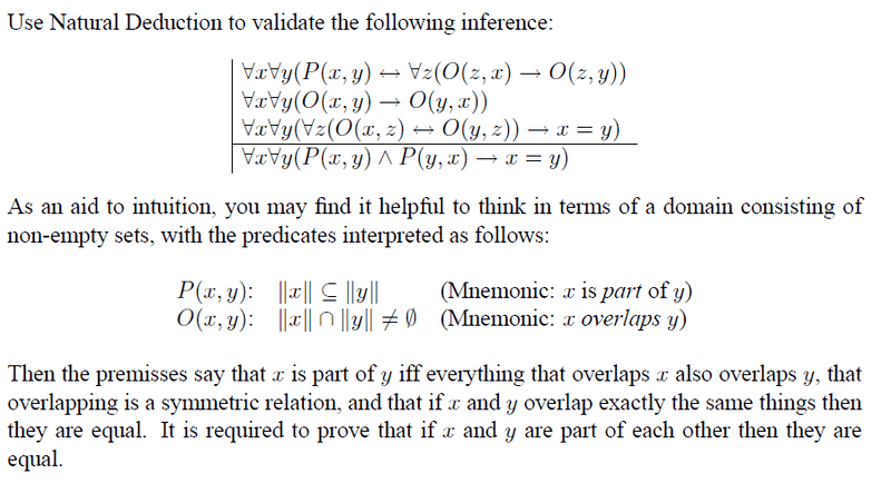

Natural deduction exercise: four first-order premises with predicates P(x, y) and O(x, y) and a conclusion that if x is part of y and y is part of x then x = y, followed by a note on non-empty set interpretations.
Can anyone lead me off here? I've broken down the three premises using 'for all' elimination, now I need to start a subderivation with an assumption, but I'm not sure what!
Right now I'm unsure of the strategy I need to use to get to the conclusion, what do I want to be left with to manipulate into the conclusion?
Would be grateful for any help!
A list of the inference rules I have learned so far for Natural deduction can be found HERE

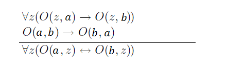

Natural deduction sequent: two premises above a horizontal line, forall z (O(z,a) implies O(z,b)) and O(a,b) implies O(b,a), concluding forall z (O(a,z) if and only if O(b,z)).
I've reduced the problem to the above, if I can prove the above then I can prove the whole thing! (I think..!)
Any help on this one? Thanks :)
Apparantly my above inference isn't valid so I cannot proceed with this method
My initial assumption is assuming P(a,b) & P(b,a)
Really stuck, would appreciate help!
