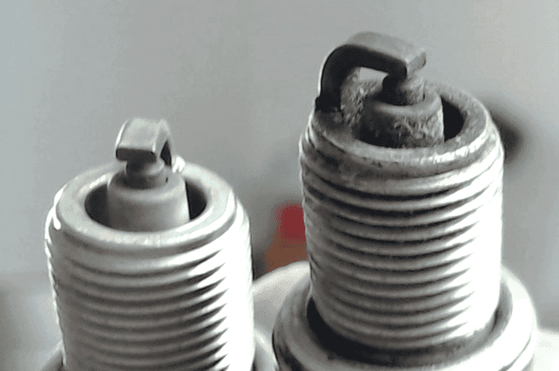

Here's the result compared to a plug of similar condition:
https://drive.google.com/file/d/0B9HHPLN8L5MxeVY2NTd3Y2xTZlk/view?usp=sharing
It was certainly a success.

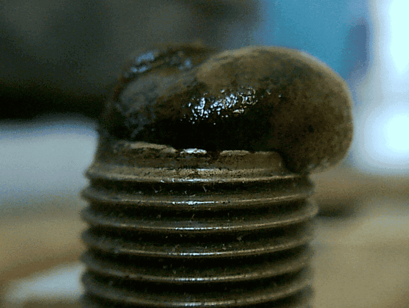

I'm now testing with the plug upright.
I placed a few granules (without aluminium) around the electrode gap, then dropped droplets of water on them.
The liquid expanded.
It is sat there now with a bubble of black liquid set to burst, being held in place only by surface tension gripping around the top electrode.
I'll leave it for a few hours.
https://drive.google.com/file/d/0B9HHPLN8L5MxR1BRUnNvd3p5RFk/view

The experiment was interesting, with the plug left upright overnight in the black gel.
I think the problem is that the black gel seems to stain the ceramic core slightly
The best solution, to deal with the inner base of the plug, is a stiff 'thin flat' brush, and oven cleaner, to agitate out the worst of the gunk.

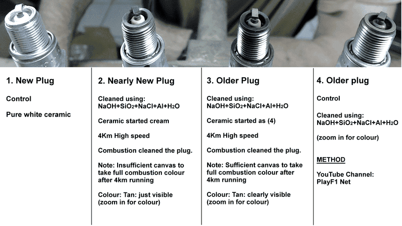

1st phase testing
Foreword
After phase 1 tests, the results show the impact of NaOH + NaCl + H2O when applied to spark plug electrodes.
The results can be summarised:
Combustion deposits are broken down, and can be removed by brush agitation with water.
Where excessive deposits existed, either the ceramic insulator was stained, or the original stain was not removed.
However, the surface presence of 'combustion deposits' were removed... the plug became cleaned, but for the ceramic staining (IE. it was not white).
Notes:
Anybody wishing to repeat these tests... I would recommend a careful choice of plugs.
4 stroke plugs meet with little oil during combustion.
The ceramic begins life 'white'... the remaining stain after cleaning is shown here
2 stroke plugs do meet with oil during combustion AND that oil can be of coloured synthetic type.
This oil 'paints' the plug, making 'combustion colour identification' extremely difficult.
Here can be seen a B9ES run with 'blue' (literally) 2T oil, after cleaning.
The plug is clean of all deposits, but the ceramic is far from white.
There are two questions that arise from this:
  1. Can the engine combustion finish the job, and either clean the plug, OR, deposit a new layer
    IE. Has the chemical cleaning done it's job?
  2. Must the search continue, to return the ceramic insulator to a white condition?
The answer to point 1... baseline tests have been completed - the comparative tests will be done tomorrow.
Point 2... the tests continue.

Back to the testing results
The first thing to note is that there was no 'apparent' further improvement in efficacy, either by adding detergent, or oven cleaner.
To be honest, my stock of plugs was now down to 'nicely burned' two-stroke plugs... you'll see how nicely burned they were.
Adding dish-washing liquid seems to be the big win, from a chemistry perspective.
It seems to dramatically impact upon noxious gas production/emittance, reducing it to the point of making it smell quite nice (if you like Savon de Marseilles).
The problem with my remaining stock of plugs, was that they had been 'painted metallic grey' by the semi-synthetic 'blue' two-stroke oil.
The NaOH + NaCl + H2O solution had no real impact upon this surface staining.
So again... from a chemistry perspective... the solution is perfect for the title of this thread.
It has no impact on the 'semi-synthetic oil' colour deposits.
We could leave it at that.
For me, it's a big win.
However, I thought that I'd share the final results pictorially, and in video format, for members who are particularly interested in engines and tuning.
Here's the photo of 4 spark plugs... all are cleaned in the solution except the new plug, shown as a control.
The second control is a plug that has been cleaned, but not run.
Read the text in the photo... it should explain everything.
The video... maybe I should have made two videos... one short vid showing the cleaning method and safety etc... and another showing plug colours.
But for me the whole subject is intertwined.
So it ended up being a 22 minute video (as usual), providing all the details.
Maybe I'll do a quick three-minuter just for the YouTube generation.
Highly Zoomable Image of Four Spark Plugs
https://drive.google.com/uc?id=0B9HHPLN8L5MxQWlXV3doLVdoUkk
Fouled Spark Plugs - cleaning and testing (definitive method)
