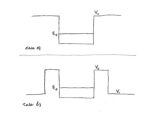

I'm not sure how far back we'll have to go.
... Tell me, do these two sketches (click here) mean much to you?
