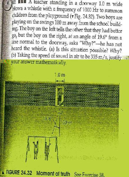

What Determines the Distance Between Two People Based on Interference Patterns?

wave velocity = frequency * wave length
Well...I'm not sure. I know how you could find the distance to the person to the right using trigonometric, but I don't know how to actually answer the question (mathematically). Interference might have something to do with it?
The width of the doorway (in wavelengths) should be important.
Consider having one whistle, and two echos (one from each side).
Regards,
Bill
Yes; the sound wave is passing through a wide slit, so this is a single-slit diffracion problem.
