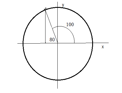

How does the "unit circle" provide the rationale for saying sin 100 = sin 80? Why is sin 80 = sin (180 - 80)?
You can't say "sine = opposite over hypotenuse" when the angle exceeds 90 deg!
Etc.
QUOTE="rude man, post: 5782708, member: 350494"]How does the "unit circle" provide the rationale for saying sin 100 = sin 80? Why is sin 80 = sin (180 - 80)?
[/QUOTE]Your two equations sin(100°) = sin(80°) and sin(80°) = sin(180° - 80°) are saying exactly the same thing, since 180° - 80° = 100°.
As to why sin(100°) = sin(80°), the cosine and sine of an angle are defined as, respectively, the x and y coordinates on the unit circle for an angle θ[ whose initial side is along the positive x-axis, and whose terminal side extends from the center of the circle to unit circle. (x, y) = (cos θ, sin θ) are the coordinates of the point on the terminal side that intersects the unit circle.
The angle 100° has a terminal side in the second quadrant. If you drop a vertical line segment down to the x-axis, you get the reference triangle (a right triangle) as shown in my drawing here.
The acute angle at the origin for this reference triangle is 80°. By symmetry it's easy to see that the triangle I've drawn in the second quadrant can be flipped across the y-axis to get a right triangle in the first quadrant. Clearly sin(80°) is equal to sin(100°) by this symmetry - both triangles have exactly the same altitude, and both have the same hypotenuse (= 1 unit).
It shouldn't be too much of a stretch to see that the magnitudes of the bases of the two triangles are the same, but opposite in sign, so cos(100°) = - cos(80°).

And so what? No one is claiming that 80° = 100°, but the sine of 80° = the sine of 100°. Similarly sin(30°) = sin(390°), even though 30° and 390° are different angles.
Getting away from trig functions, do you have a problem with someone saying that ##(-2)^2 = (2)^2 = 4##, even though ##-2 \ne +2##? It's really the same idea -- the squaring function and all of the trig functions are not one-to-one, so different inputs can have the same output.
