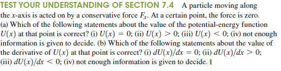

apathetic_operator
see image
potential energy
"The force is zero" means the total force act on the particle is zero? Then there must be an external force. If not, then Fx=0 ?
since Fx = d(U(x))/dx, the answer of (b) should be (i), but how about (a)?

Yes for part b). For part a):
If ##U(x) = 0##, what does that tell you?
apathetic_operator said:
how about (a)?
Can you construct counterexamples to any of the options?
It means the value of ##F_x## is zero.
... you should be able to answer the question you asked.
