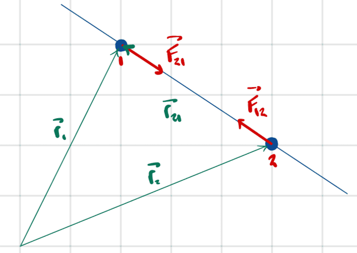

Suppose we have two objects: object 1 and also object 2.
If we consider the system to be both objects, then we can compute the work done by the pair of internal conservative forces
$$\int_A^B \vec{F}_{21}\cdot d\vec{r}_1+\int_A^B\vec{F}_{12}\cdot d\vec{r}_2\tag{1}$$
$$=\ldots$$
$$=\int_A^B \vec{F}_{21}\cdot d\vec{r}_{21}\tag{2}$$
where ##A## and ##B## represent states A and B of the system.
(2) is be definition of the integral itself equal to ##\Delta K_{sys}##.
For a gravitational field, we end up with
$$W=Gm_1m_2\left ( \frac{1}{r_f}-\frac{1}{r_i} \right )$$
which shows that work depends only on the difference in initial distance ##r_i## and final distance ##r_f## between the two masses.
Change in potential energy of the system is defined as
$$\Delta U=-W=-\Delta K_{sys}$$
and by defining the potential energy at some reference point we obtain a potential energy function.

zenterix said:
My question is about what happens if instead of analyzing a pair of conservative forces in a system, we split the system and consider just one of the forces.
That's what we do in cases 1 and 2. The force on the mass or planet is external, in the sense that the mathematics takes nothing else into consideration. These basic models consider only the one force and the motion of one body.
zenterix said:
Not sure what the distinction is between your cases 2) and 3).
In 3) we consider the motion of both bodies around their common centre of mass. This is called clapping with both hands.

When we analyze a system of two objects,
we start with a pair of forces. Each force is a function of a position vector. When we calculate the work done by the pair in moving the system from a state A to a state B, we compute the work done by each of the forces in the pair.
However, after a few steps we end up with
$$\int_A^B\vec{F}_{21}\cdot d\vec{r}_{21}\tag{1}$$
which is the work integral of a single force.
##\vec{F}_{21}## obeys the following relationship
$$\vec{F}_{21}=\frac{d^2\vec{r}_{21}}{dt^2}\frac{m_1m_2}{m_1+m_2}\tag{2}$$
which shows that (1) is calculating the work done on a "reduced mass" system (with mass ##\mu=\frac{m_1m_2}{m_1+m_2}##) with position ##\vec{r}_{21}## inside a force field ##\vec{F}_{21}## that is fixed in time for each ##\vec{r}_{21}##.
Thus, to compute the work (and potential energy function) for a system of two masses it seems we've reduced the problem to a single mass ##\mu## inside of a fixed force field (thus, fixed gravitational field).
We know that ##\vec{F}_{21}(\vec{r}_{21})=\frac{Gm_1m_2}{r_{21}^2}\hat{r}_{21}##.
The gravitational field is
$$\frac{\vec{F}_{21}}{\mu}=\frac{G(m_1+m_2)}{r_{21}^2}\hat{r}_{21}$$
So we can solve (1) and we end up with a potential energy function of ##U(r_{21})=\frac{Gm_1m_2}{r_{21}}##
