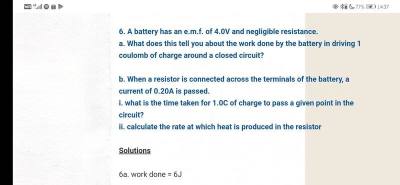

P=IV
why is answer for (6a)6J?
ellieee said:
Homework Statement:: nil
Relevant Equations:: P=IV
Negligible resistance means that the battery is a perfect source of DC voltage. The voltage at it's terminals is constant regardless of the current drawn.
The answer is not 6J.
then is the answer 4J?
Yes.
