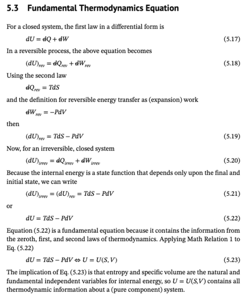

Which brings me to my original question. Here is the portion of the book that generated my question
My question is about equation (5.21) above.
It seems that the idea is that if we go from an initial state with internal energy ##U_1## to a second state with internal energy ##U_1+dU## then since ##dU_{rev}=TdS-pdV## and ##dU=dU_{rev}=dU_{irrev}## then it must be that ##dU_{irrev}=TdS-pdV##.
If we keep going with such infinitesimal changes in ##U## then we would be able to say that ##dU_{irrev}=TdS-pdV## for each such step.
But somehow this doesn't make sense to me since the irreversible process doesn't seem to ever proceed in such an infinitesimal manner.
it is valid only if the initial and final states are closely neighboring thermodynamic equilibrium states. In terms of TdS and PdV, it is not valid at all points along an irreversible path.
So is the book vague, misleading, or incorrect?
Judgment call. I regard it as both incorrect and misleading.
