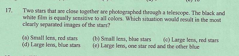

See figure attached.
I'm really confused as to how to solve this question. What concept does this question have to do with?

I like Serena said:
Looks to me as if you indeed need the Rayleigh criterion.
See: http://en.wikipedia.org/wiki/Optical_telescope#Angular_resolution
How do I get any data from the question? The only thing I can determine is whether the diameter of the lense is small or large. What does the colour of the stars have to do with it?
